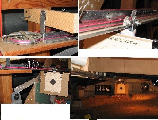

GaryN
Posts: 637
Location: California
Re: Home range targets
Post by GaryN »
Just for background, this is my AP/AR setup located under the house in the crawl space.
The ground slopes, and the end where the trap is located is literally crawling high.
Hence the need to use a target carrier, so I don't have to crawl in the dirt to change targets.
Because of the very limited vertical height, I could not use the target carrier pulley that Pilkingtons sold. I had to use something with a rail/track.
The carrier mechanism was done on the CHEAP, and cobbled together from parts from Home Depot and Ace Hardware.
I just had to be creative in finding and figuring out how to use stuff for what they were not designed for.
I do have to put the AP or AR down to crank the target in, and change the target.
For AP, I don't have to move my feet. Although I usually do move my feet, just so it won't cramp, from no movement.
But if I shoot AR, the pulley is behind me, so I have to break position to work the pulley.
That limited vertical height also limited me to a 10x10 trap.
