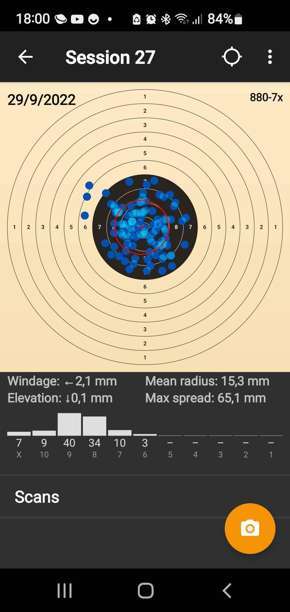

This is my current level btw…

The shots off to the left (assuming you are right handed) are most likely anticipating the shot and applying finger tip pressure.
