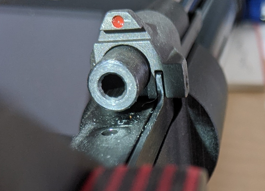

Yes, the Izzys have a 30+ degree crown. The AV's is more like 170, barely more than shaving off the rifling lands. They end several mm before the muzzle. It's certainly different, but as I said, the pistol shoots beautifully in my testing so far.
I have a borescope, if I can get some internal close-ups I'll post them.

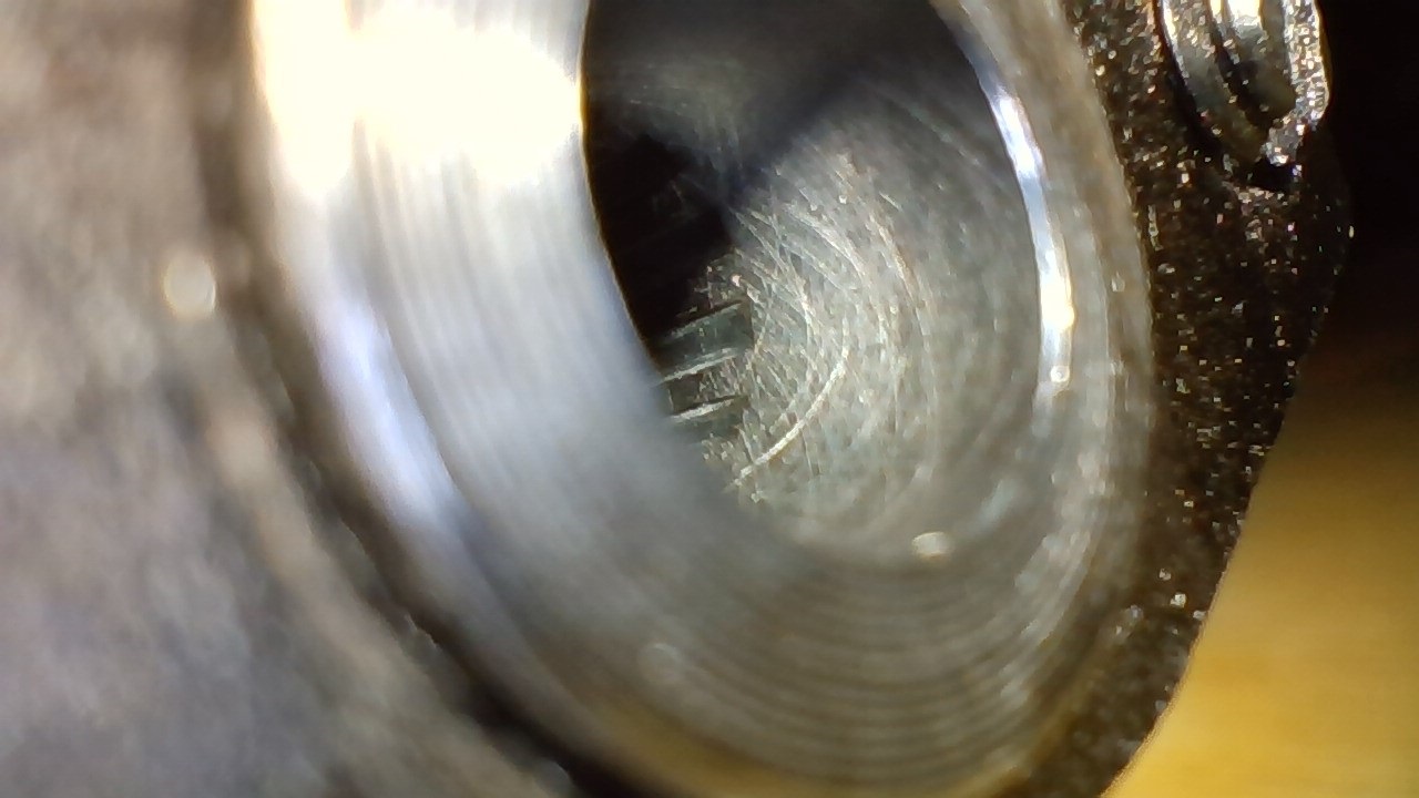

My borescope is 5mm, too large to even get into the crown. But I lined up a little bit outside it for a closeup.
The lighting is poor and the reflections make the crown look rough, it really isn't. But what it does faintly show is that the actual crown angle is not flat, it goes in as a 5.8mm cylinder at first, then seems to take on a ball shape. Interesting.
Closeup of internal crown

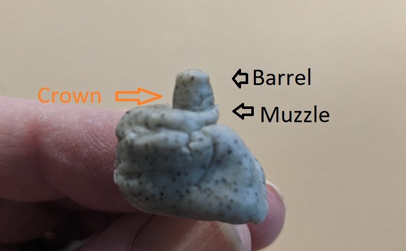

Here's an impression using modeling clay. It's more of a bullet-shape!
Crown is about 4.75mm deep, from end of rifling to surface of muzzle.
Crown impression
Crown impression

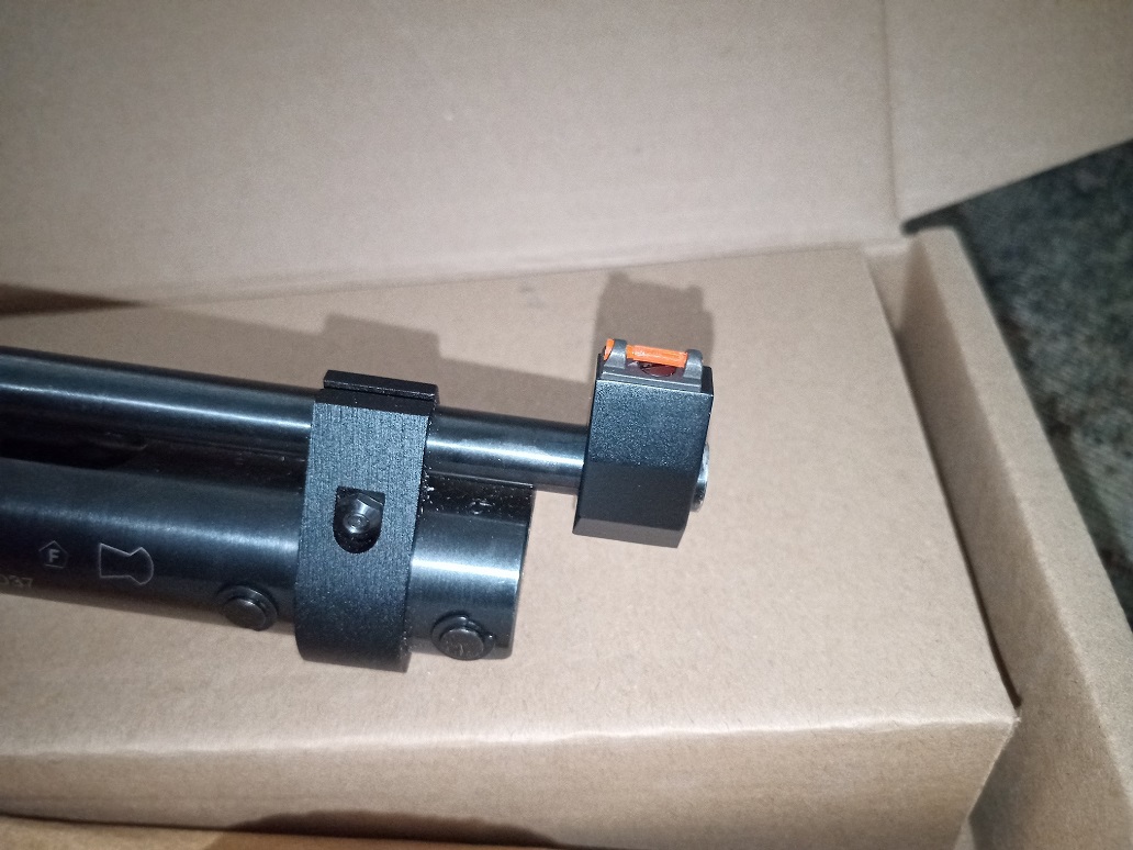

I got my "New" Izzy between Christmas and New Years. First thing I did was take a riffler file to the sharp corners on the grips and made a new front sight mount with a fiber optic. I made one for my original "Izzy" too.

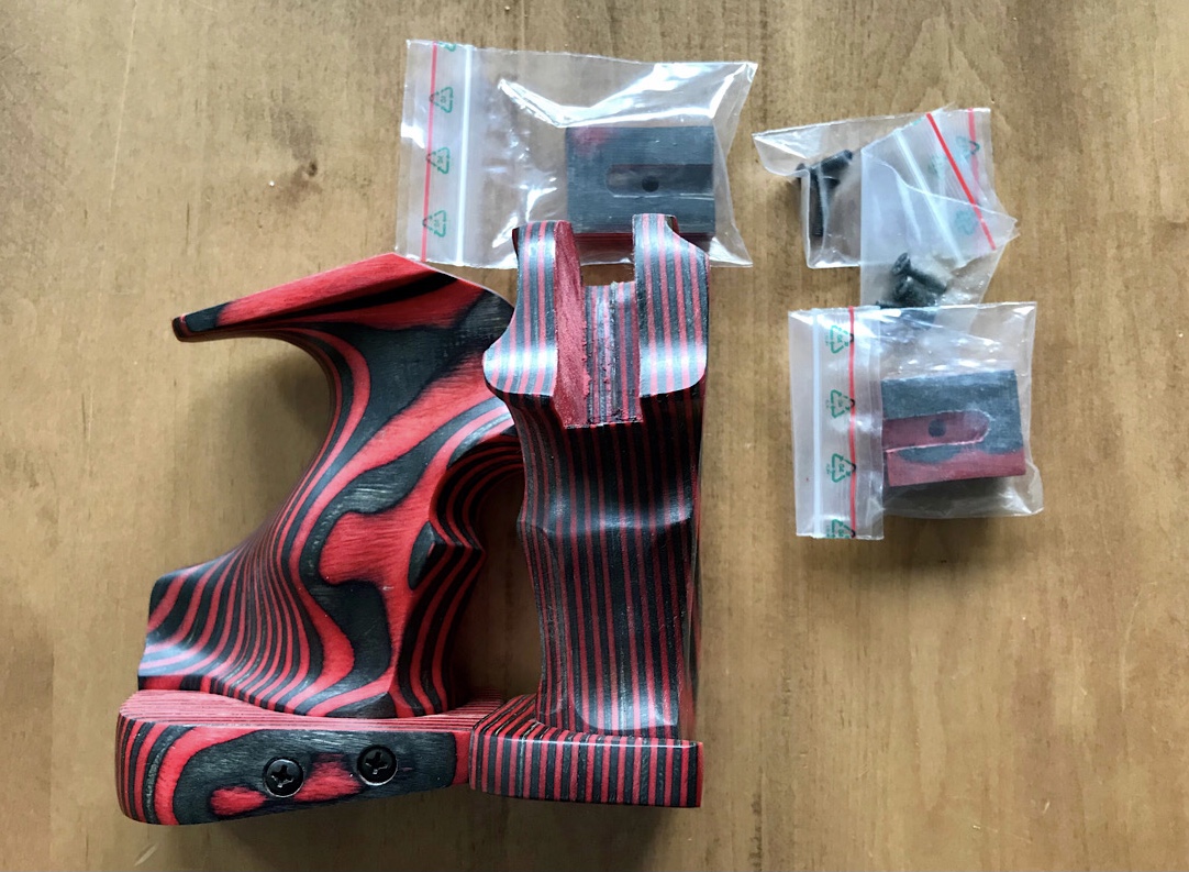

Is the grip shown a one piece or two piece. Mine just arrived today and it looks and feels like a two piece. Hoping its not a crack down the whole grip.
Posts: 629
Re: "New" Izzy from Air Venturi
The AV-46 has grips made by Minelli. They are two pieces that are glued together to make a one piece grip. The seam is slightly visible, but is not a crack. The Minelli grips certainly seem to be a weak point for these pistols. Which, is why we have Rink grips on ours. I attached a photo of the ones we have in a drawer, at the range.
