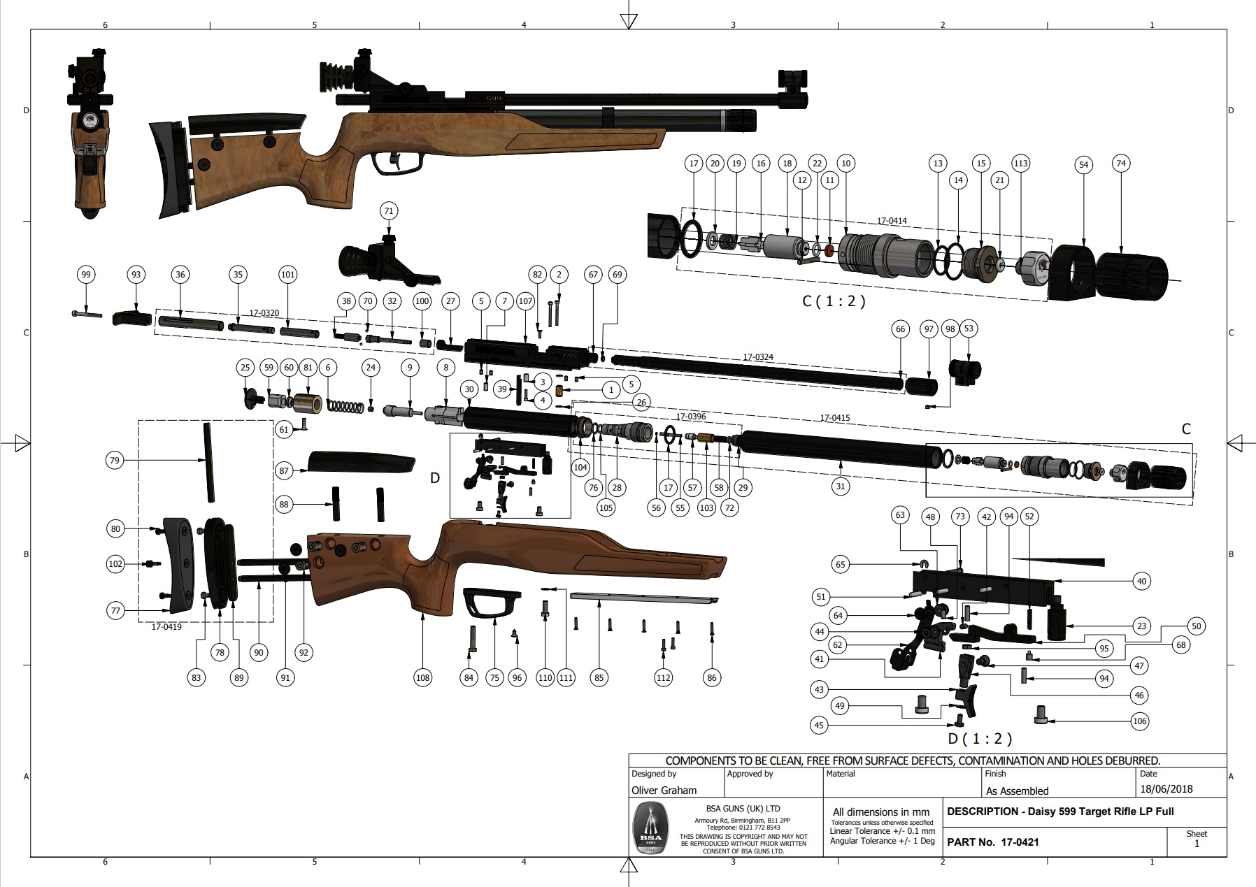

We just ordered some parts and Daisy sent this diagram with updated price list. After looking over the pdf more carefully it appears it's missing a lot of information.
599 Price_List_and_Diagram_2024.pdf
(490.5 KiB) Downloaded 959 times

Yeah, It's a pretty good diagram. The bubbles are pointless though as they don't appear to be referenced on the parts list. Thanks for the PDF. It's high res so that helps.

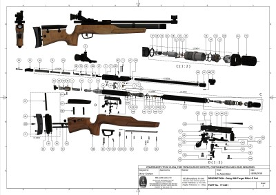

Daisy 599 Complete Exploded View

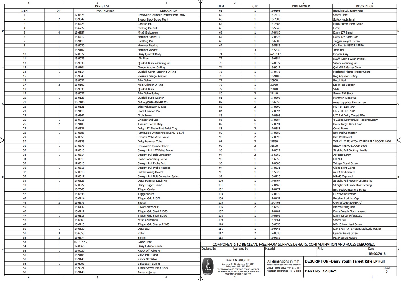

Daisy 599 Complete Parts List
Found a way. Hopefully this will help with all those that have these rifles. Daisy sent me an e-mail saying that I could not purchase Item #94 by itself, but that I would have to purchase the seal and screw kit, but then didn't send me a link to that kit, and I can't find on the Daisy ws. Go fig.
Anybody happen to know what that set screw is? Maybe #2-56??? If someone knows I can just order from McMaster-Carr.

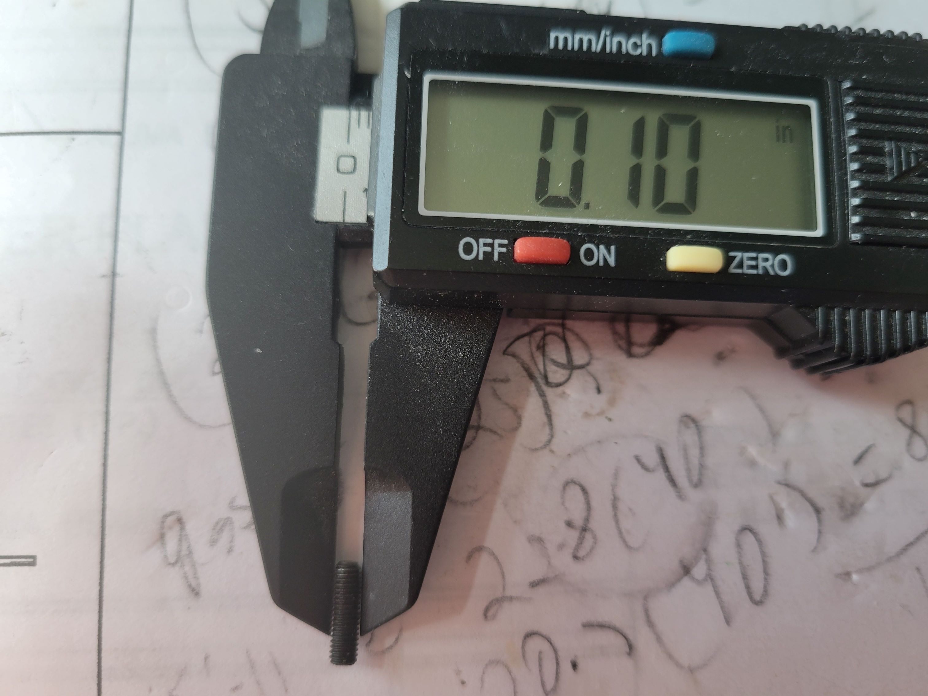

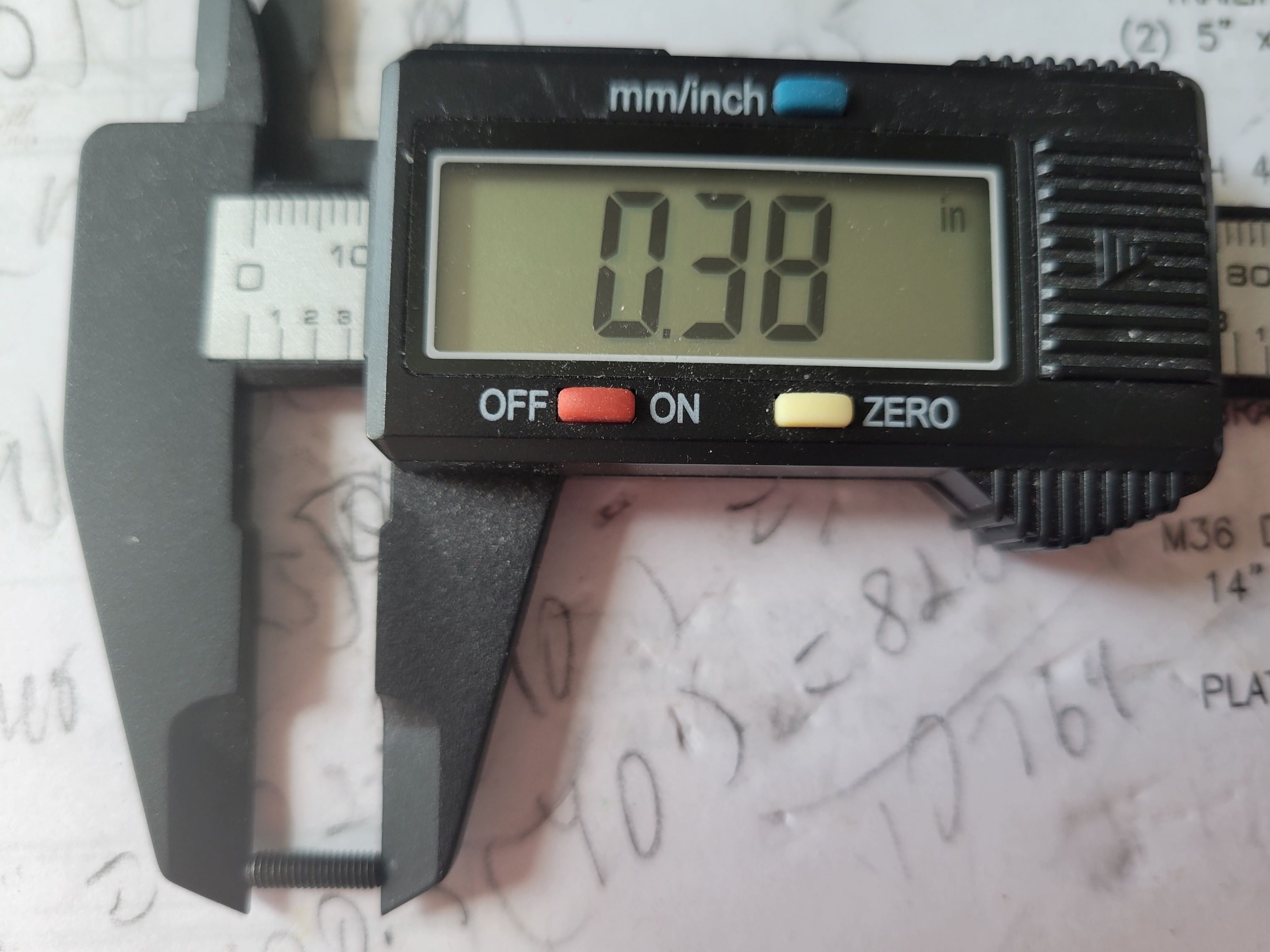

here are a couple of pictures of the screw for dimensions. My aging eyes can't tell if its a #3-48 or #3-56 x3/8" long, considering every other item listed is a metric screw/nut then maybe a M2.5? Either way i've loaded the pictures so you can decide for yourself.
