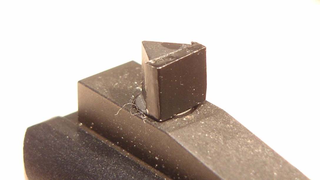

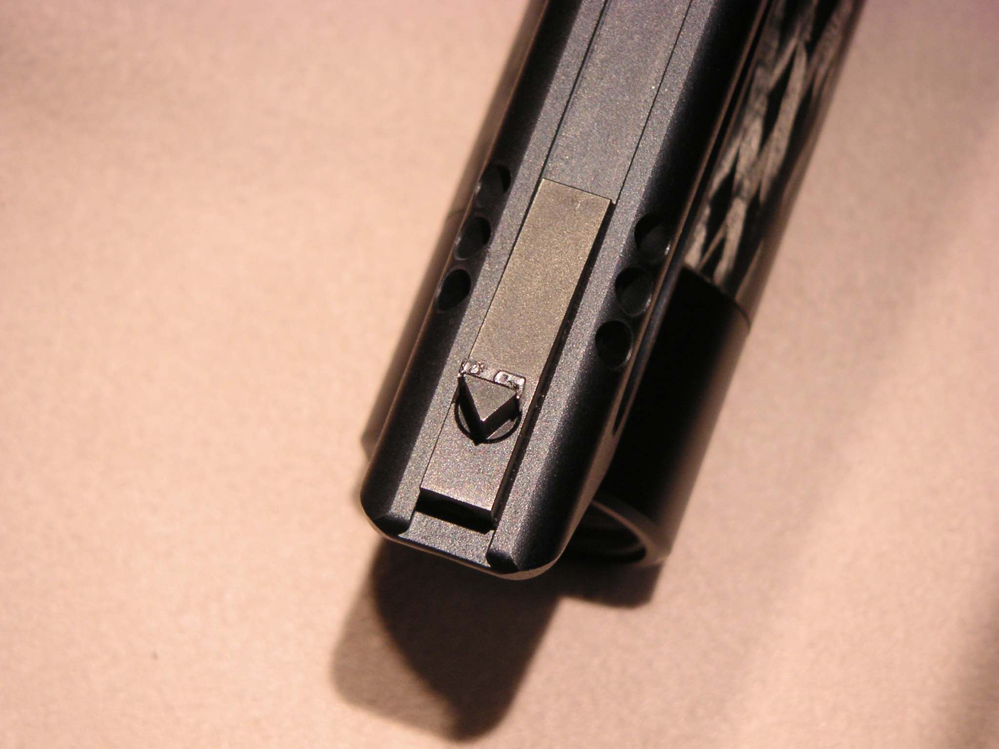

My Walther LP500 came with a standard turnable front post. It is a triangle pole which has 3.8, 4.4 and 4.7mm faces. An optional larger one has 4.0, 4.5 and 4.9mm faces, which is better for me than the standard. I did not rush to purchase the larger one, because 4.9mm is still too small. I cut a 2.0mm-thick Aluminum plate into a shape which has a 5.4mm-width face and painted in matte black as shown in the photos below.
