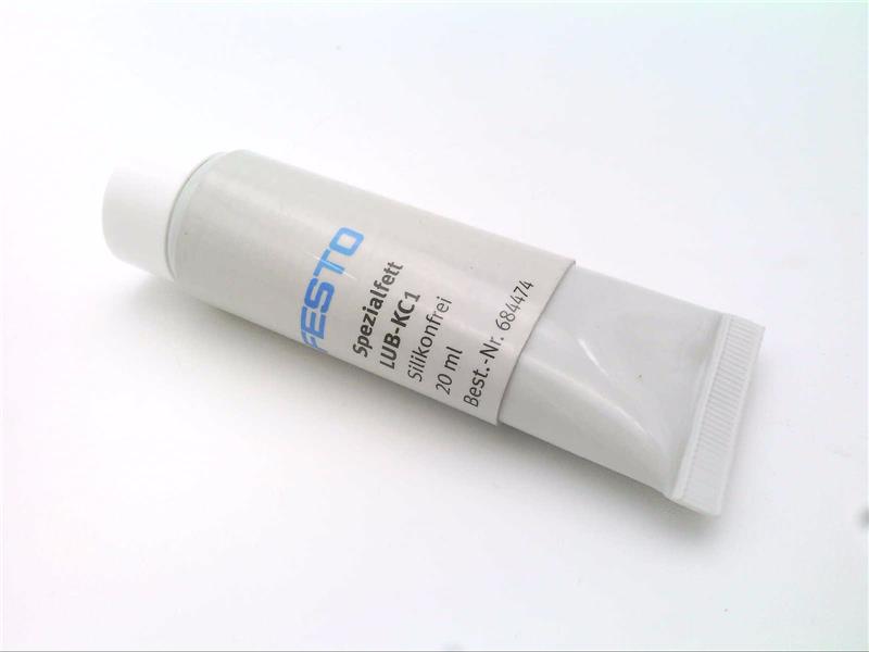

My favorite is Festo Pneumatic assembly grease.
