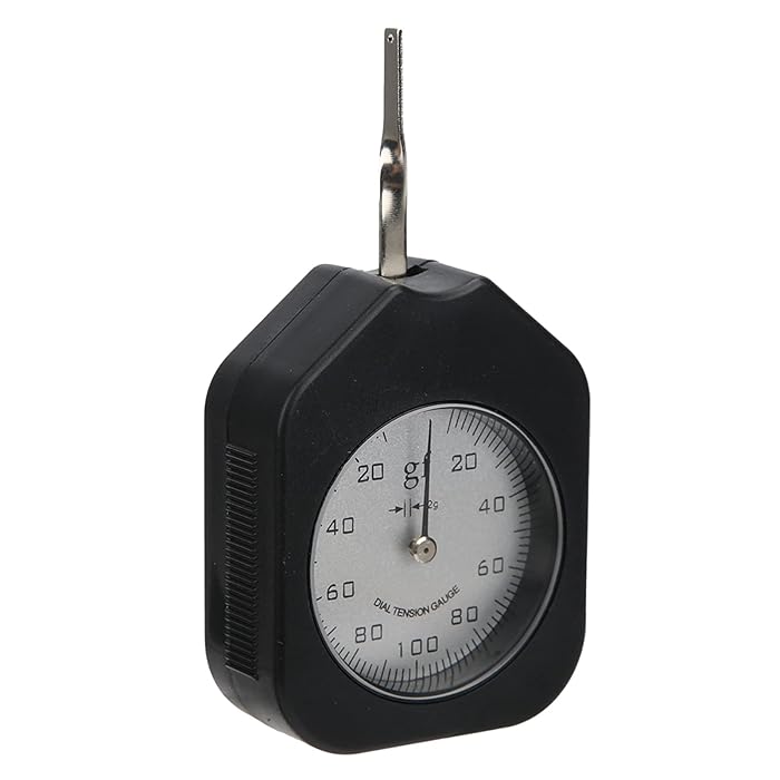

The other problem is that the shooters adjusting these triggers do not have the dial relay weight test gauges to read and set these intermediate trigger weights. They only have a total trigger 500g weight and the rest is guess work.
