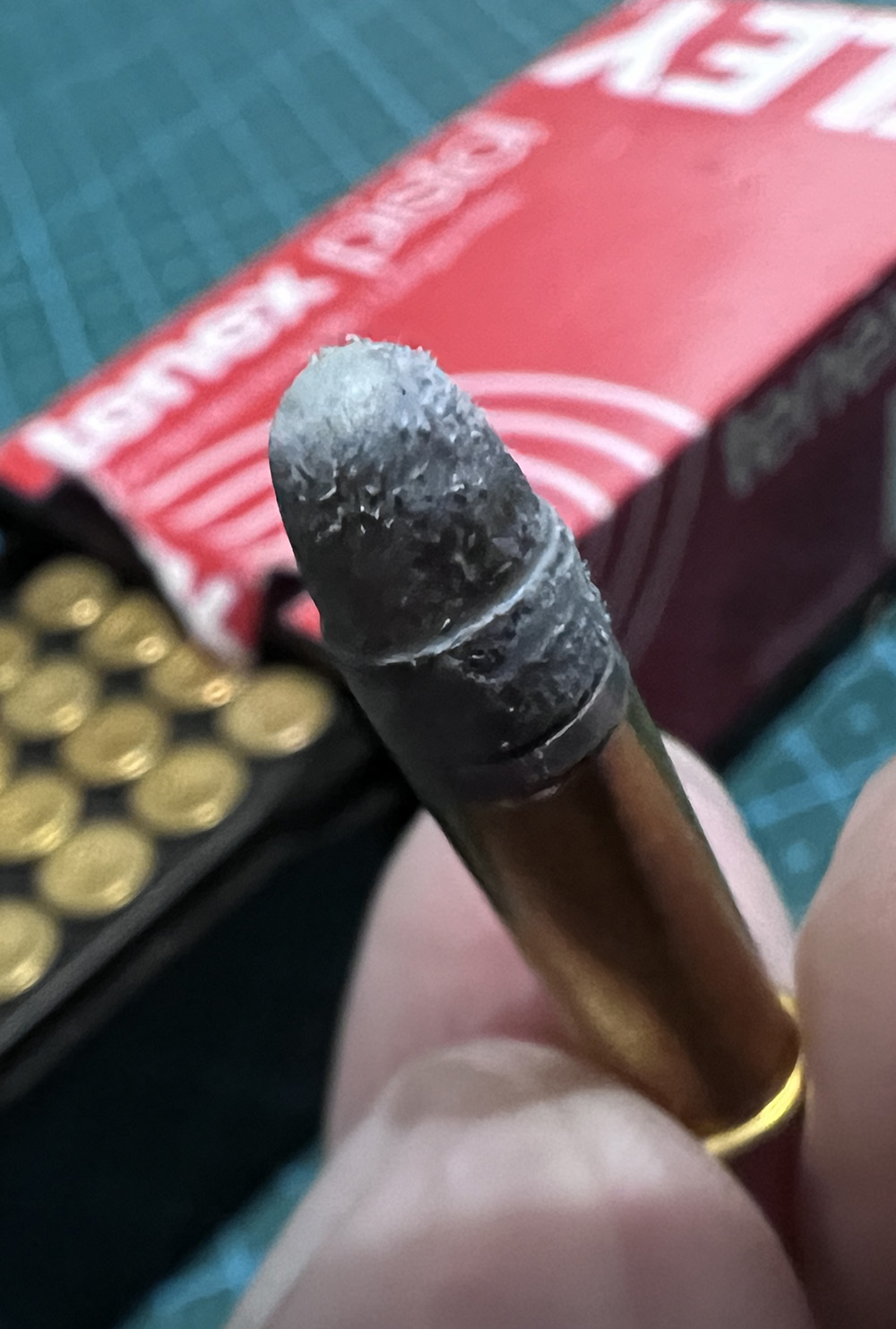

Does anyone have experience with cleaning oxidised ammo?
I've read a couple threads and found vinegar or vinegar mixed with salt can do the magic? But still want to double check before I do it as it's my first time dealing with oxidised ammo.
Thanks in advance.

From my experience, wipe it off with a dry towel, and move on. Cleaning loaded ammunition leads to misfires, alibis, and death (if one uses the ammunition for work.)

Dry towel and move on. The less you mess with it the better.

I did some research on this a while back when I was selling a bunch of old ammo. The white stuff isn't lead oxide, which is either yellow or red. The white stuff is more likely the lube oxidizing, and in my experience, whatever Eley uses tends to do it more than a lot of other brands. Just wipe it (lightly), and shoot it.

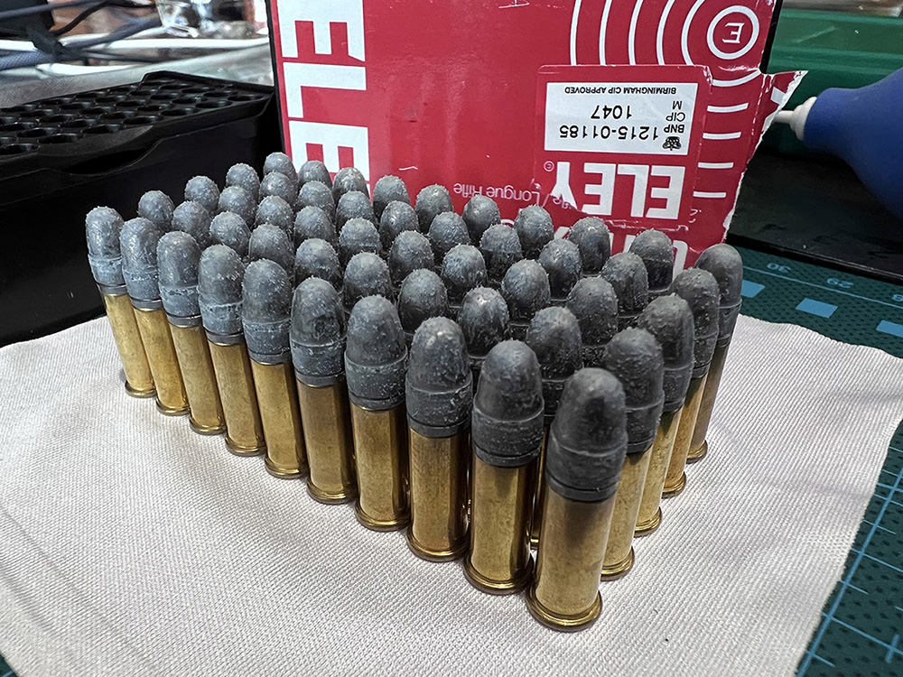

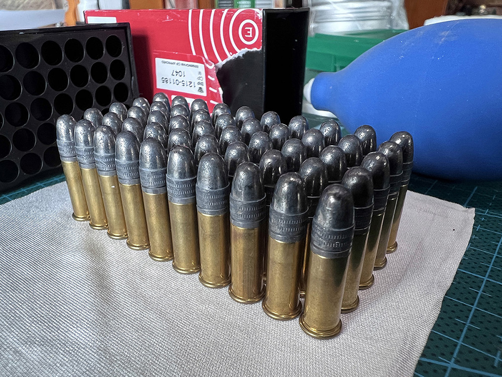

some result with dry wipe.

GWhite was right. It’s just some lube oxide. Very easy to wipe off.

BTW, I shot 90 rounds with my TOZ and put 10 rounds through my friends CZ rifle today. Those cleaned Eleys worked just fine.
