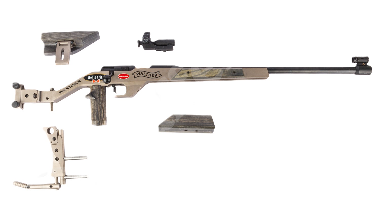

Is this a Walther KK200?
Post by SteveP02 »
Just seen this for sale and am interested but the description is all over the place, not least as having it as a .177 air rifle. KK200 is mentioned. Could anyone confirm the action and stock please?

Re: Is this a Walther KK200?
That looks like a KK200 to me. The stock is the early machined version, with the broomhandle grip. I can't see the bolt, but I expect it has the gold-ish (titanium nitride?) coating. The trigger blade has been swapped for a FWB, but everything else appears to be a Walther part.
Some early rifles were branded KKM200.
Post by SteveP02 »
Thanks Tim, that gives me a bit more confidence. I will try to arrange to get a look at it in person.
Happy to help.
Obviously the usual caveats about any 25+ yo rifle apply. Do make sure the large thumbscrew that locks the cheekpiece is present, as it's not in the photo. I'd presume this is the same as on the KK300 alutec, but it would save time and expense if the seller has it.
I'd add I think the rearsight is the appropriate type for an early KK200.
Post by SteveP02 »
Good point, and you are spot on about the gold bolt body btw. I'd thought it was a bit younger so will revise my value estimate.
Steve,
The KK200 was made until the early 2000s when the KK300 took over, so it could be a newer barrel/action and a stock from 1996-98. The early 2000s is still 20+ years old though!
That appears to be a factory barrel, so it should bear the standard Ulm proof marks which include the year it was tested. For all intents and purposes the year of proofing will be the year of manufacture. You're looking for two small letters; the first will be either a K for (19)9x or an A for (20)0x.
Post by Alan Paul »
Hi Steve,
I have a very early KK200 stock which i Bought as soon as they were on sale through NSRA. What you have does look very similar apart from the pistol grip, what is fitted on mine is more like a standard thumbhole stock pistol grip. I purchased mine originally and put my match 54 barrel and action in to it. Then later purchased a new graded barrel and action. Currently thinking of upgrading again to a 54-30 barrel and action but can't decide whether to get a new stock or keep this one.
Alan,
Walther changed to a more safely grip around 1998; Chris Fordham, then owner of Bedford Target Suplies and author of the Brookwood colum in Target Gun/Shooter, reviewed the early machined KK200 (as in Steve's original post) in the February '98 edition, but the newer cast/MIM type in June '98.
