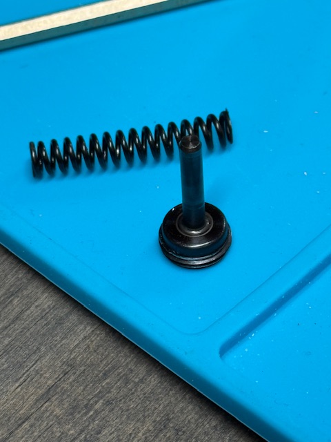

My Pardini K12 is shooting slow. Using a chronograph (Garmin) it is shooting around 108mps or 350fps with H&N final match and slower with RWS R10. Other quality air pistols using the same chronograph during the same testing session are shooting around 158mps or 490fps.
Observation: The screw MP is fully screwed into the frame. When it is loosened the velocity decreases to 80mps or 260 fps.
While it is hard to diagnose a problem sight unseen, I’m wondering if anyone has had a similar issue. The firing pin spring is intact, but slightly curved. Not sure if a new spring or stronger spring would make a difference.
Thank you in advance
Brian

I replaced the firing pin spring with a generic coil spring nearly identical in size to the factory spring that my local gunsmith had on hand. Not it shoots consistently 480fps. I also inspected the o-rings and they are all present and appear to be in good shape.
I’m still going to order a replacement spring from Pardini.
