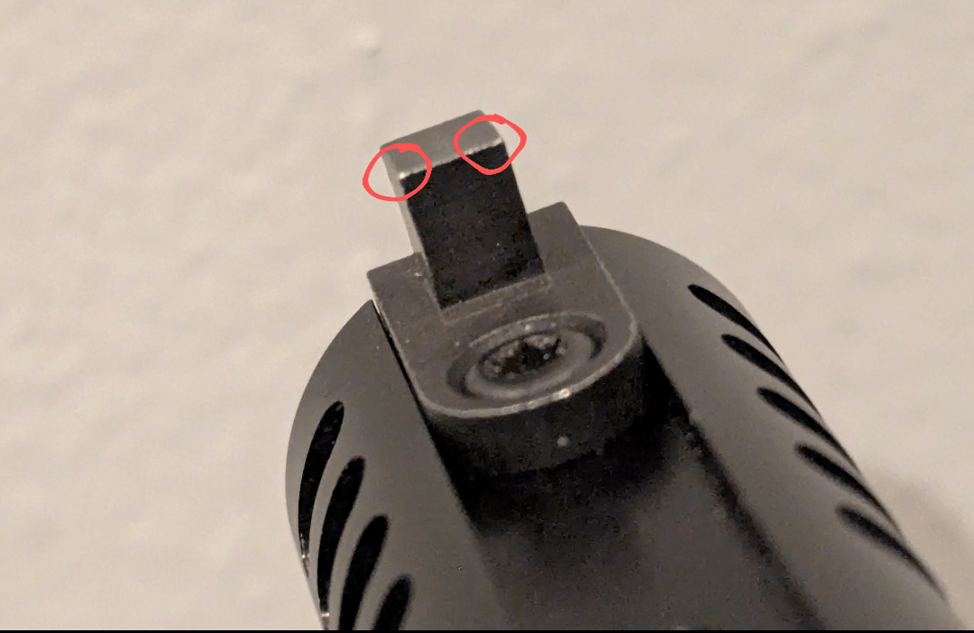

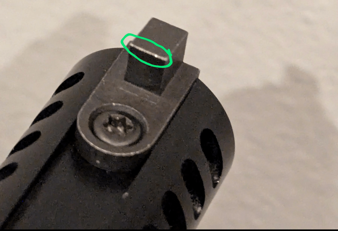

Hi,
I hope all is well. I am a brand new shooter (4ish months in) who recently got a used gun. The gun works great, but the sights are a little scuffed up.
Namely, when I try to line everything up, I can see a rough edge on the front sight (and rear sight to a lesser extent). I can see the discolorations and scratches. This is making it hard to get a perfect sight picture as I can't 100% tell when it's all aligned.
The variation in color (black where it's in good condition, but more silvery in other spots) also adds inconsistency.
Any thoughts on how to beat fix this?
Thanks!
