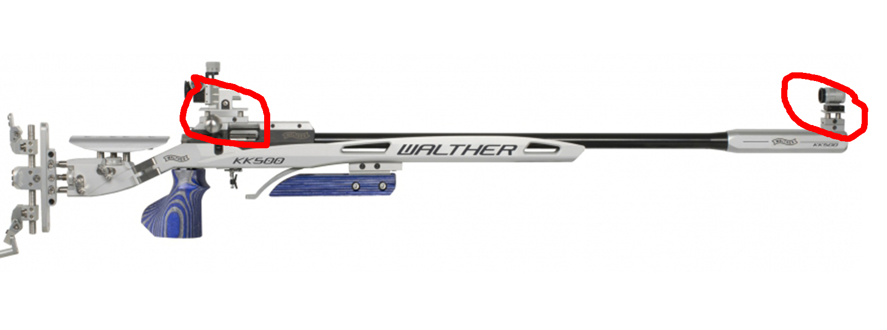

In the case of answer anschuz or blieker, grunig, the rear block height is the same as the front block height, but in the case of walther kk500, is the rear block height different from the front block height?
If you look it up on the Internet, there is one more front side block installed.
If I buy kk500, will one front sight block be installed as a service?

The extra block on the front sight compensates for the rear sight bridge over the action. It should come with the rifle. But you will need to purchase extras if you buy multiple sight sets or use the same one and take the adjustable risers off of it. The newer Anschutz 54.30 comes with one to compensate for it's rear sight bridge

For the Walther KK500, in standard condition it comes with two rails for the front rails: one on the front and one on the rear, so the sight blocks are the same height.
