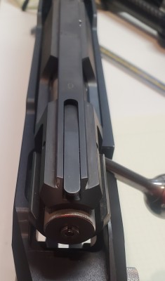

When you unscrew that little rail section (the “bridge”) on the KK500, it just lifts off and you can see the two screw holes underneath

Re: walther kk500 scope rail? bridge...
Post by 1845greyhounds »
My KK500 in an Anschutz Precise stock...
hyeyong76
Posts: 14
Joined: Fri Apr 25, 2025 4:00 am
Post by hyeyong76 »
1845greyhounds wrote: Sat Apr 26, 2025 4:20 pm My KK500 in an Anschutz Precise stock...
wow thank you
Posts: 2102
Is that the bolt release at the back of the dovetail?
1845greyhounds
Posts: 105
Location: Fishers, Indiana
Yes, pushing the lever down is required to both remove and reinstall the bolt.
@hyeyong76 - the rail is part of the receiver and made of steel. The silver add-on rail is aluminum.
