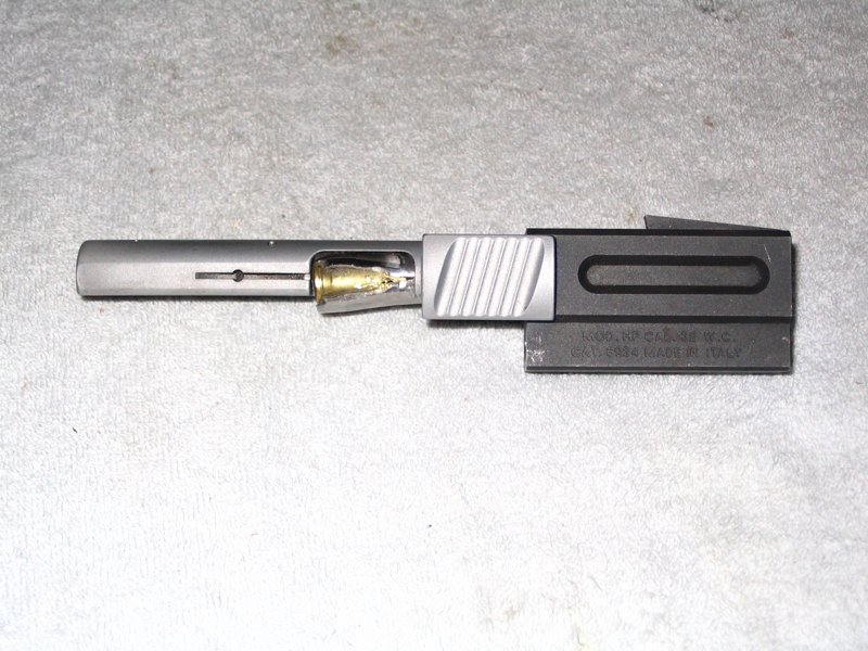

Hello all,
I have acquired some PPU .32 SW Long LRN 98gr bullets. The overall case length is too long for my pardini. It is loaded with 1.7 grains of a powder that looks like little thin square confetti.
My question is, can I just push the bullet head down into the case like this:
Or will this blow up my gun?

I don't know the direct answer to your question but why risk it when there's so little to gain? I wouldn't even think twice about using instead the right ammo for the gun.cjon600 wrote:Hello all,

Re: Pardini HP 32, ammo talk
NO! Because you will reduce the room inside the case. This will greatly raise the pressure.
To be honest, I don't know if it will matter with a very light charge in the .32.
cjon600,
Jeez, never change a load by pushing the bullet down: that increases pressure with unknown consequences! DANGER WILL ROGERS!
If you want to load 32 S&W L wadcutters, you need to use a deep belling powder funnel as made by Dillon specifically for that cartridge (part 20064 for the 550B); seat the bullet flush with the case lip, and barely crimp. I've never loaded that round for Pardini pistols, but it is my understanding that they are vulnerable to blowing out the magazine when loaded too hot.

Can I just push the bullet head down into the case?
Sure, let us know how it works out for you.
It could end up like the attached image...
fc60:
Ouch! Could you explain what happened. I assume that was a 32 S&W L? dipnet
It was not my pistol so I cannot say with certainty what happened. I suspect a "poofer" round did not clear the barrel and the next round fired.Dipnet wrote:fc60:
Fortunately, I was able to remove the old barrel via end mills and several setups. The owner had friends in the industry to check the bolt with MagnaFlux and it was okay.
I machined a new barrel for him and he is shooting with us again.
In summation, the above had an equivalent of a 196 grain bullet and too much pressure. Seating bullets deeper, as suggested earlier, increases pressure a lot and is something I would not try.
STICK TO THE LOADING MANUALS! Those folks know what they are doing.
