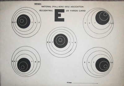

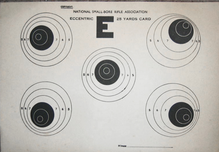

As others have said, for the mainstream manufacturers like Sius, Meyton & Megalink, the "aiming mark" is actually just a hole in the mask. There's no physical target that you could go back and compare against the monitor or printout (unless you fit a witness sheet, but that's not a target with rings on and is mostly useful for detecting cross-shots). Although it may feel "untidy", it literally doesn't matter whether the target's calibration is actually in the centre of that hole or off to one side - you can't see where your shots are falling.
Obviously it is desirable that the calibration be fairly close to centre simply so that you don't have shots tearing up one edge of the mask - especially for 10metre where you can see holes in the mask with the naked eye.
Coming to it as a predominantly outdoor shooter, any re-zeroing you may have to do against the target's calibration is usually hidden by adjusting for wind anyway. It is perhaps more obvious for air shooters, particularly air-pistol shooters who don't tend to adjust their sights much. I recall someone on this very forum replying to a question about adjusting pistol sights who said that if you were grouping away from the bull then it must be because something changed in your grip and you should figure out what that was. If your sights are zeroed from training then it must be you! This is perhaps technically correct (if you can know for sure the sights haven't been knocked or shifted in transit), but the majority of the other posters simply weighed in "if it's a consistent group then shift your sights for heaven's sake, don't throw the match". Don't be scared of your sights.
This willingness to tweak your sights is perhaps more important with EST, but has always been important as you travel to different ranges with different lighting, etc.
