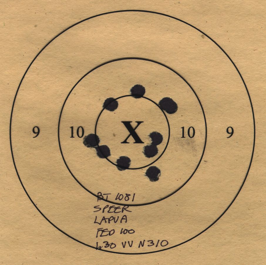

fc60
Posts: 751
Target Grouping
Post by fc60 »
I am sure Walther use a mechanical fixture to test their barrels. I have never been able to duplicate the factory results using a Random Rest.
Not sure what to say about the Benelli. Perhaps it was fired from a sandbag rest?
I have attached a test target fired at 50 yards of a fast twist barrel I did for a fellow Benelli shooter. This group was a result of using a mechanical fixture.
