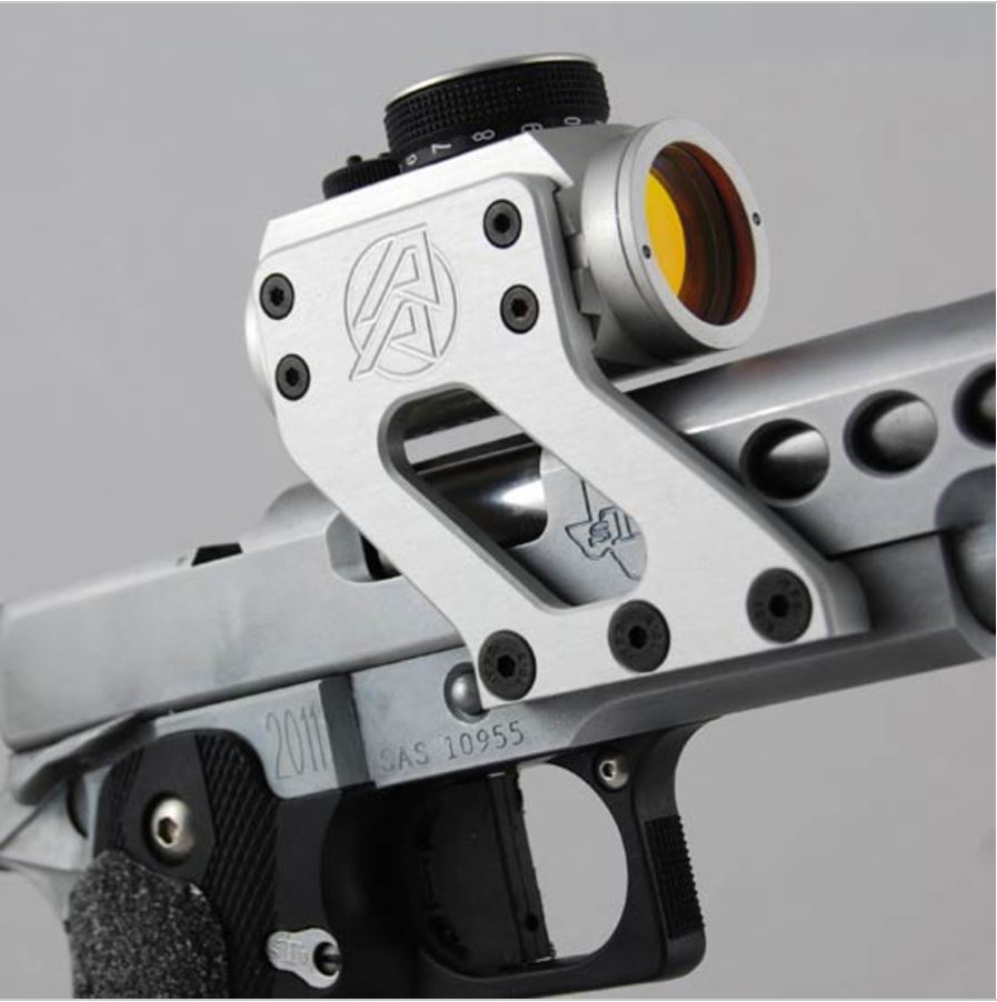

Post by SPPcoach »
That is some beautiful gunsmithing. I did notice that Steve Reiter was running his H1 Micro sights slide mounted.
I really like the Aimpoint Micro. I am surprised that an enterprising gunsmith has not created a frame mount that attaches to the right side of the frame (passenger side) and turns the Aimpoint 90 degrees counterclockwise. This would allow the scope to be mounted even lower to the bore than the mounts that place the Aimpoint upright and place the screws 'under' the scope. The dot intensity adjustment would then be on the top of the sight.

Post by SPPcoach »
That was such a good idea I knew that someone would make it.
It is low mounted, solidly attached and has great ergonomics . . . and yes the empty brass will eject.
http://www.doublealpha.biz/daa-aimpoint ... ight-mount

Re: What reddot did Zins use at Perry?
Post by Isabel1130 »
Shouldn't that be on the other side of the gun? And not blocking the ejection port? It might not interfere, but still, all my frame mounts are attached from the other side.
