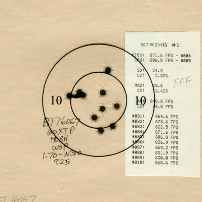

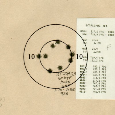

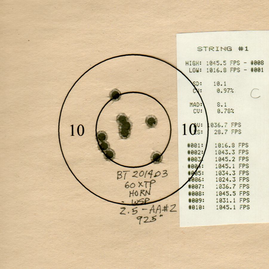

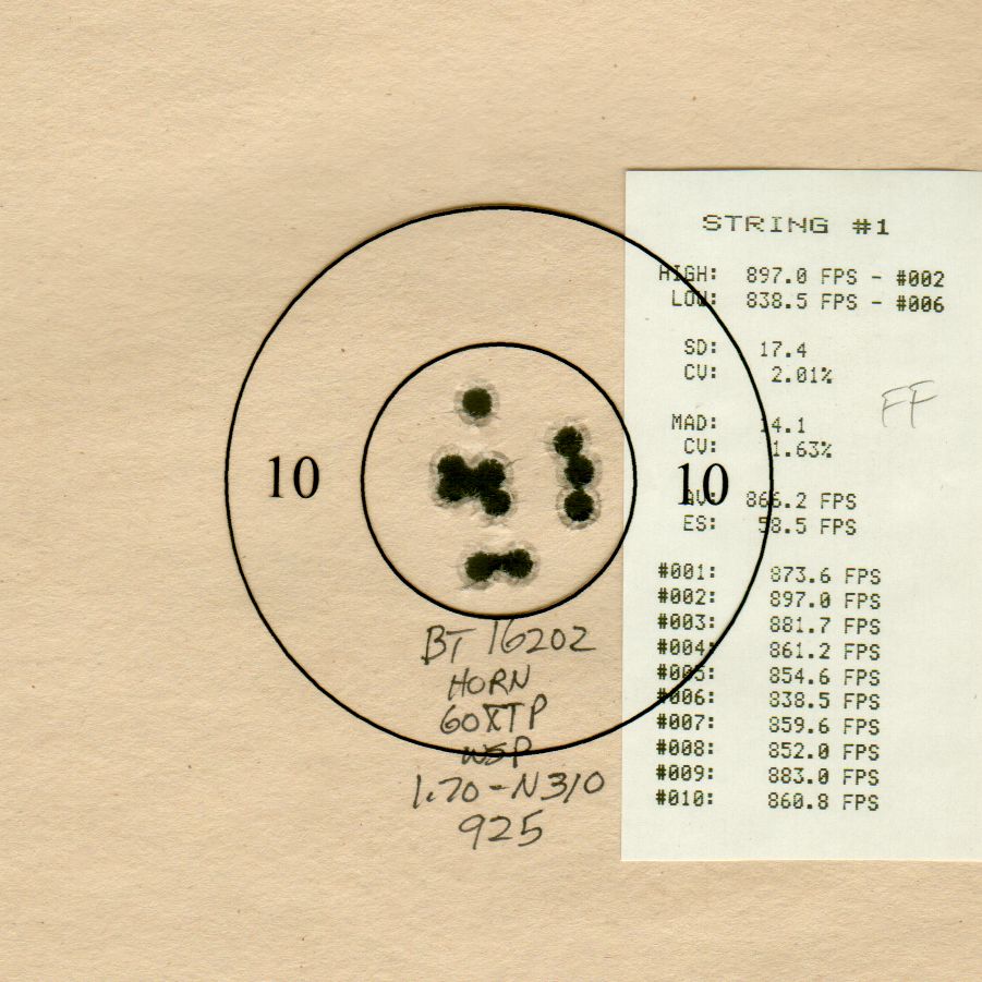

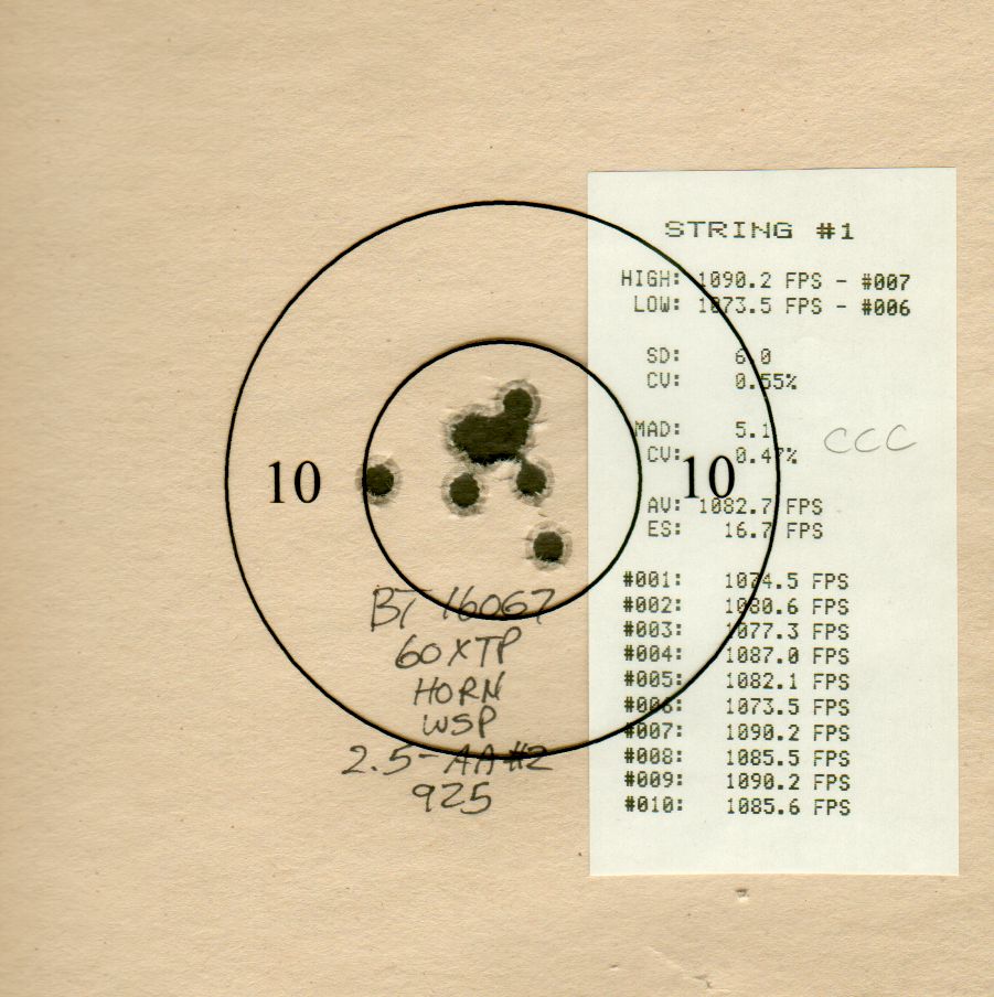

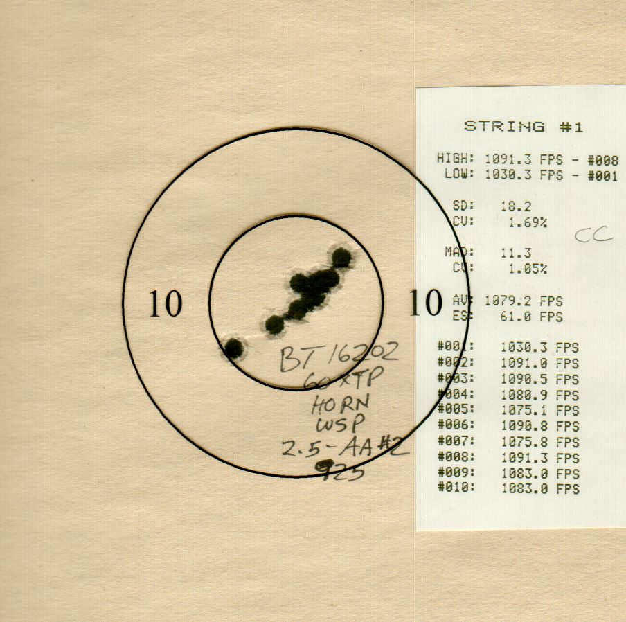

Re: Pardini HP 32, ammo talk
Time to revive this old post.
Went testing yesterday. The goal was to see if the published load data would match my hand load data. Thanks to Hornady for listing data in their #9 book for the 60 grain XTP bullet in the 32 ACP.
Attached is a PDF of my results.
Some notes.
The PardiniUSA barrel is 0.314" groove diameter with a 17.7 twist. The Douglas barrels measure 0.311" groove diameter with 14 twist. The chamber profiles are very similar to each other PardiniUSA/Douglas. All barrels head space on the case mouth.
The Douglas barrels shot higher velocities which I expected. Good news, is the increase is not that significant.
Since I do not have a Pressure Barrel to test undocumented loads, I am at the mercy of the Big Manufacturers to provide safe information.
Bear in mind the variation in powder lots, barrels, and chambers. My chambers are tight and would suggest maximum pressures.
Two loads stood out with regards to accuracy. VV-N310 and AA #2 shot very well in all three barrels. The test targets, fired at 50 yards from a barrel tester, are attached along with a PDF of my Chronograph data.
As you can see, the PardiniUSA barrels shoot very well.
BT2014.03 is the PardiniUSA barrel
BT16202 is Douglas #1
BT16067 is Douglas #2
