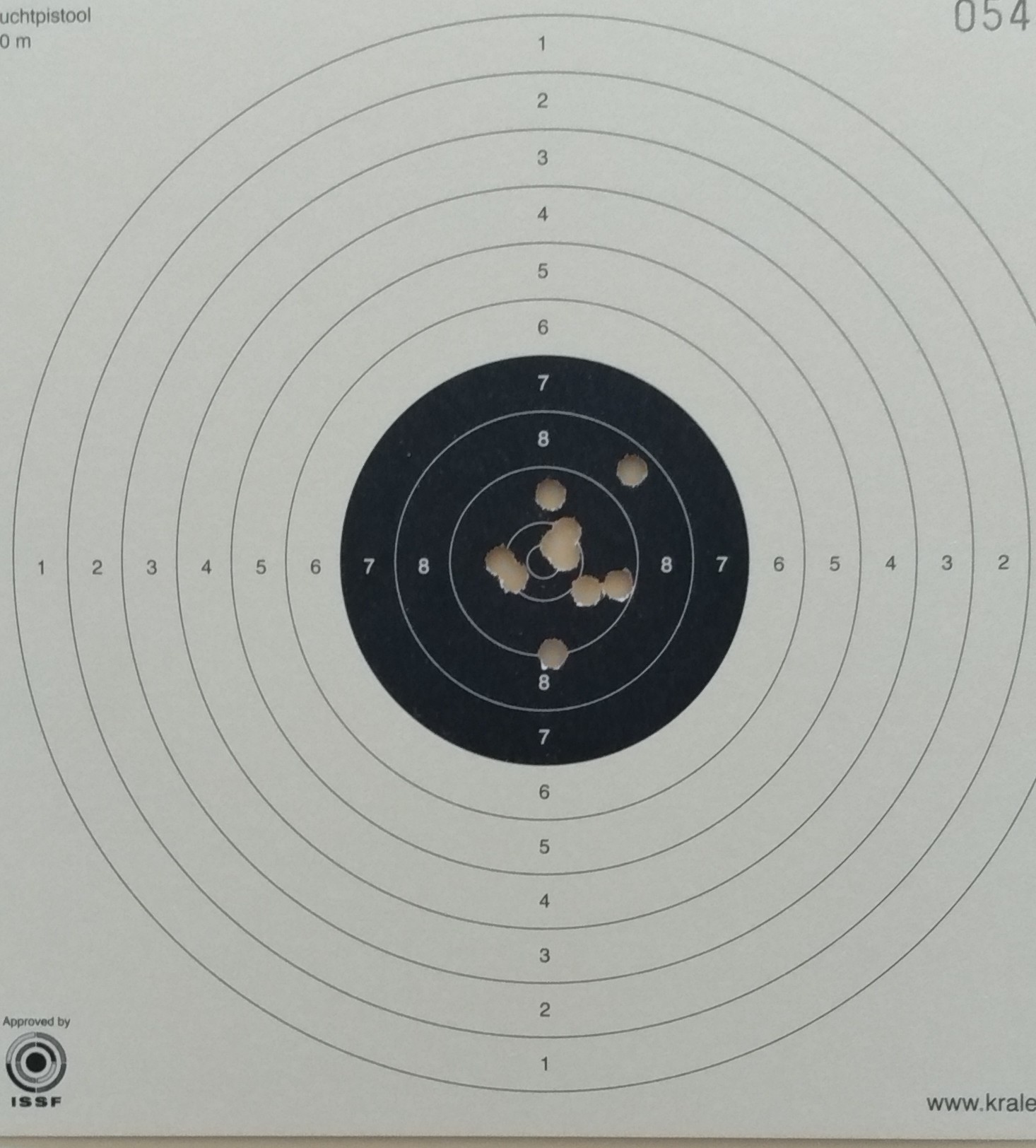

Its not my target. Unge posted it as an example of a hard to score target. I just scanned it with Targetscan to illustrate where all ten shots are likely hiding.Rover wrote: ↑Wed Jun 16, 2021 8:10 am Brent375's target provides far more useful information than a mere score, which doesn't mean anything in practice.
For example: he has a VERY nice group going...does he need a zero change?
What caused the "8"? How to fix that?
The "9"s on the right look a little off, but the entire group in the "9" ring could just be a normal random variation. ???

If the zero is shifted so that the nice cluster is centered in the 10-ring, the 8 becomes a 7 and at least one of the 9s becomes an 8. I think all the "misses" being a bit high and consistently right is revealing - probably a result of repeating one (small) error. Anticipating the shot? But what do I know? I merely quote Shakespeare and make reference to Salvador Dali.Rover wrote: ↑Wed Jun 16, 2021 8:10 am Brent375's target provides far more useful information than a mere score, which doesn't mean anything in practice.

If you trust the target quality, I think missing one is X

If you are right handed, shots up around 1:00 to 2:00 are often anticipation. All it takes is a tiny bit of increased grip pressure to push a shot in that direction.
As an experiment, get your normal grip, stance, etc., line up your sights , and intentionally tighten your grip a little bit. See if the sights move in that direction.

You are most correct. Squeezing the trigger totally independent of the second finger isn't always easy.Gwhite wrote: ↑Wed Jun 16, 2021 9:14 pm If you are right handed, shots up around 1:00 to 2:00 are often anticipation. All it takes is a tiny bit of increased grip pressure to push a shot in that direction.
I should dry fire more, I just get bored really fast doing so.

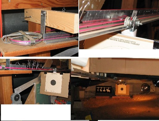

Just for background, this is my AP/AR setup located under the house in the crawl space.
The ground slopes, and the end where the trap is located is literally crawling high.
Hence the need to use a target carrier, so I don't have to crawl in the dirt to change targets.
Because of the very limited vertical height, I could not use the target carrier pulley that Pilkingtons sold. I had to use something with a rail/track.
The carrier mechanism was done on the CHEAP, and cobbled together from parts from Home Depot and Ace Hardware.
I just had to be creative in finding and figuring out how to use stuff for what they were not designed for.
I do have to put the AP or AR down to crank the target in, and change the target.
For AP, I don't have to move my feet. Although I usually do move my feet, just so it won't cramp, from no movement.
But if I shoot AR, the pulley is behind me, so I have to break position to work the pulley.
That limited vertical height also limited me to a 10x10 trap.
