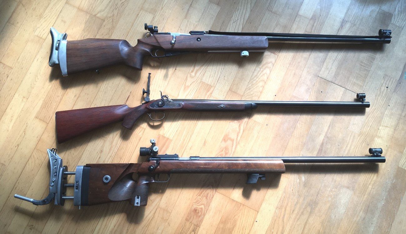

It´s been a while, but I still shoot with the 1613.
Have also shot 300m matches with old M27-66 7.62x53R rifle.
My latest gun purchase was a muzzleloading rifle: "Creedmoor Match" that I use in MLAIC events "Vetterli" and "Whitworth"
That Vetterli event is 13 rounds in 30min, standing position, 50m at issf pistol target. I cast my own bullets, but still it is 0.25€ every time the Creedmoor goes bang. So began to think that I could use that 1613 in training shooting from standing position during winter. No need for expensive ammo there, 0.08€ TopShots/CCI std´s will do just fine. But there is quite bit of weight difference...
Creedmoor is cal .45 and has enough recoil to bruise my shoulder if shot without a jacket; 290gr bullets and light (3.5kg) gun do that.
Just put the 1613 on a scale. It weights 6.5kg ready to shoot.
* 3kg for Stock & accessories (buttplate assembly weights 1.33kg)
* 3.5kg for barrel, receiver, bolt and sights
1613 could be made lighter. There´s no way to make it weight 3.5kg, but I´d be happy with weight of ca. 5.5kg ready to shoot. The barrel on 1613 is 70cm long, diameter 24mm. What would be shortest usable length with a bloop tube, maintaining accuracy for not so serious, clublevel prone shooting? 10cm of barrel weight ca. 330g.
Long guns, M27-66 on top, Creedmoor Match muzzleloader middle and 1613 bottom
