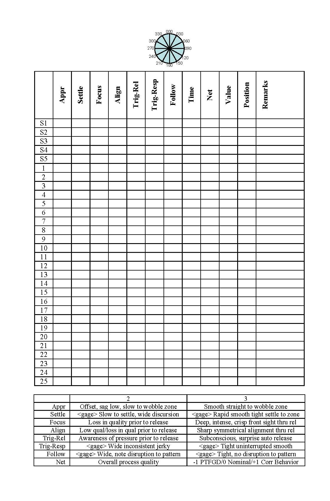

Shadow:
You ask the right question- but from what you say it is impossible to evaluate any behaviors or associated metrics.
Refer to the attached data sheet. To use, you must fire the shot (or dry fire) and evaluate your performance on the critical elements (columns).
The form was designed to be used in conjunction with the Rika/Scatt/Noptel system (see columns for quality of hold and trigger) however you can use the form simply by modifying what you use for those columns.
The purpose of using the form is actually to force you to focus on the behaviors you perform and observe- evaluating those behaviors forces you to pay close attention to them- having a record od your performance against those behaviors (metrics) is quite secondary.
Once you get comfortable with using the form, you can begin to trust yoiur evaluations.
At that point, you can begin to use the form for diagnostics- it will help you identify yoiur weakest performance areas, which yoiu can then work on the following week.
(p.s. please don't try to evaluate each area for every shot!)
Steve Swartz
Posts: 444
Joined: Thu May 22, 2008 8:06 am
Location: Auburn, AL
Post by Steve Swartz »
Oh each element is evaluated 1 (really sucked), 2 or 3 (per the legend at the bottom; if using Scatt/Rika/Noptel other evaluation options can be used).
Leave null if not observed. Enter 0 if it really, really sucked.

Steve there is some sense in your lists on the bottom of the chart. Like (my words)
assess pattern and settle speed
did my focus wander
did my alignment break from physical or mental
how aware-conscious was I on the trigger
was the trigger quick, smoothe, and not affect alignment
did I maintain focus and hold through the release and more
If I saw any break from ideal above, did I fight or put it down

I like the worksheet as a simple way to force myself to honestly evaluate the shot. Though, I wouldn't put mistakes in writing at the bottom, I want just the good behaviors. I can evaluate how close I was to the ideal. Also I might modify it to make fill in the blank circles because I am pretty hopeless writing with my left hand.
This thread and your others, Steve, have been eye opening to me. I realized that even though I have a shot plan, I have not been evaluating each step individually and it did not include the mental process I need. I have found that I need a "script" to say as I go through the process to keep my mind from wandering. I am far too easily distracted and I discovered that I was far to willing to accept it and take the shot anyway, even though I am not totally focussed on the task at hand. Thanks for helping me make the discovery.
