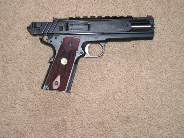

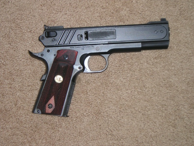

Hogue Avenger 45 ACP Test
Post by Ernie Rodriguez »
Just installed a 5" H-A conversion unit on my target pistol lower.Only broke it in for 130 shots-so far.Only ammo used was cast/swaged SWC at target velocities using BE and VV N310 powder.Impression:Quality,fit,finish,design concept,installation ease and functioning-SUPERB. This is a LEVER delayed blow back system with the bbl attached to frame via a special block.Installation allows a zero V&H movement of block/bbl via shim and minor hand fitting.Rear sights are adj for W&E and front sight inappropriate for BE competition shooting.The Hogue Gunsmith said he will send me a blade gun sight for the front.Off hand accuracy was excellent(considering the front combat sight) and no malfunctions occurred-empty shell ejection was excellent.I think this unit is inherently very accurate-due to the BarSto match BULL bbl,the bbl mounting system and free floating feature of bbl. Pistol balance-similar to a 1911 with a rib on it.Rotational torque seems less to me because of the very quick cyclical action. Recoil and second shot recovery time seem less also because less mass is involved in the cycling action. Since there is a picatinny rail on the H-A unit I will be doing scope sand bag testing using a 6X quality scope, The following week I will be testing this combination with my Ransom rest.I will be using 200 gr cast/swaged bullets and Federal GM Target bullets(185 gr FMJ SWC) as a reference. Cheers

I think a lot of the negative reaction to the Avenger has been due to its appearance and to the many delays between its introduction and its availability for purchase. So few people have had the chance to actually shoot one that we can only guess how it might perform.
Ernie, how did you get yours?

Hogue Avenger-45ACP
I found a dealer that had one at a decent price-<opticsplanet> and it was no tax and free delivery.Shot pistol for 60 more shots-works fine-seems to me it is inherently accurate. I am going to install a 6X target scope on it and do some sandbag test at 25yds but mainly at 50 yards. Hope it is as accurate as my other target pistols.Cheers

Hogue Avenger 25yd Accuracy
Firstly-I think you can get this unit from-opticsplanet for around 1k IF THEY HAVE ANY. Attached scope today to the H-A and used sand Bags.This pistol shoots as good as any of my other custom pistols.With 200 gr cast SWC and Zero's I got groups from .6 to 1.5". These bullets were visually checked and NO load developement performed(varying powder weight) and at 25 yards only.I will cast a batch of the better performing bullets and weigh them for a serious test.At a quick glance-BE,N310 and Clay seem to be the powders of choice with 200 gr slightly besting the 185's. The Avenger is still tight as a drum and in my experience,with load developement is an "X" ring pistol at 50 yards. Cheers Ernie
