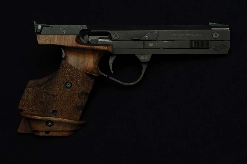

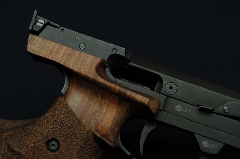

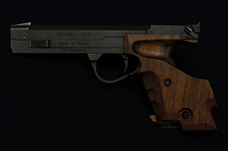

IZH For Sale
Post by investorsc »
Edited- Gun Sold
