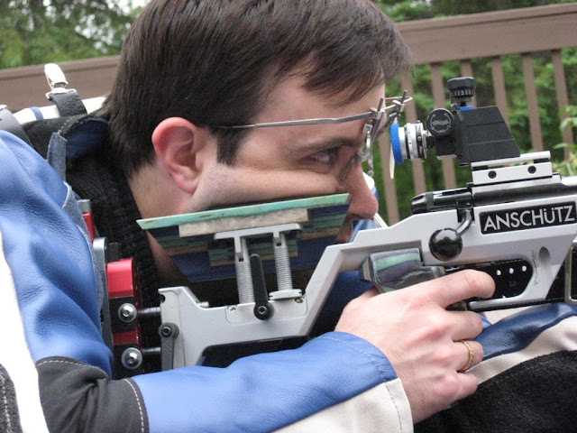

Totally! Here's a picture my son took tonight of my position:
You'll notice that my lens is a tad low and I've since lengthened the nose piece to raise it so I'm looking through the optical center of the lens.
If you have the Olympic frames you should be able to position your lens the same -- my frames are the older World Championship 2 model.

Jason wrote:You'll notice that my lens is a tad low
It would also appear to be slanting backwards slightly.

David Levene wrote:It would also appear to be slanting backwards slightly.
My head was moving because I was telling him where to sit to take the picture -- he's only 9. ;)
