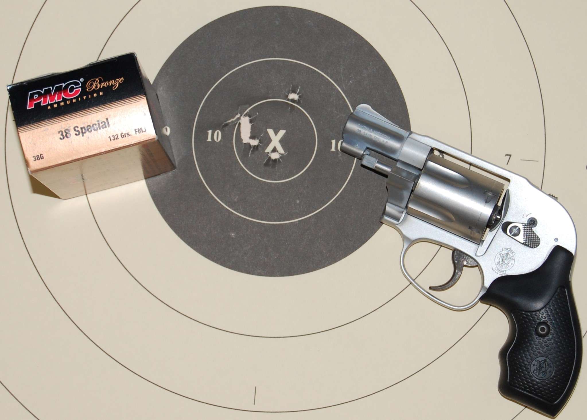

The first picture is just a baseline. It was shot with the snubbie and the PMC ammo. It's only included to show that, yes, I can hit the target if you put it close enough.

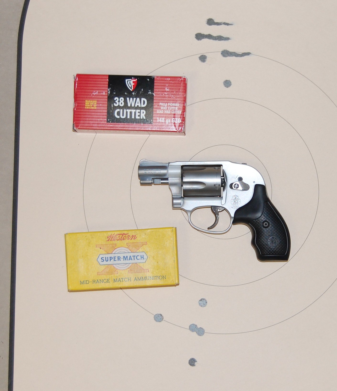

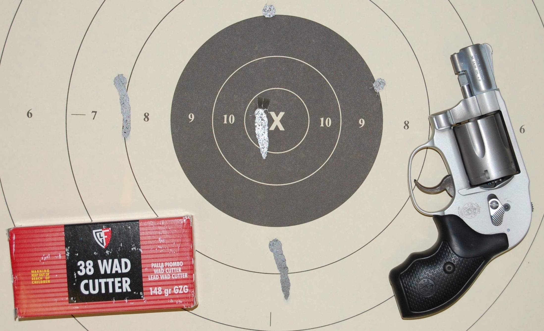

This first picture shows what happens when I attempted to put shots at 3, 6, 9, and 12 o'clock around the black as well as one in the center of a range target, using a new box of Fiocchi and the short-barreled revolver. Clearly, in a defensive shooting practice scenario where 20 or more shots will be put on one target, the long tears shown here would make the final target look nothing like a target with bullet holes. The result would be a shredded bull without a distinct pattern. This would also appear to the shooter as very bad accuracy.
Note also that the two “round” holes at 3 and 12 aren't exactly round.
As an aside - the accuracy, here, is not good but it's better than I expected. However, I contend that my original accuracy complaints are valid. For example, the range session that led to my original post had included one heartbreaker of a group at 25 yards, using a 3-inch pistol. In a 5-shot group, 3 shots cut perfectly round bullet holes as close together as any three shots I've fired in my life at that distance while 2 more landed a foot high and tore long strips from the target. Bullets that tumble so much that “tipping” is evident at a mere 7 yards are, I think we can agree, anathema to good accuracy.

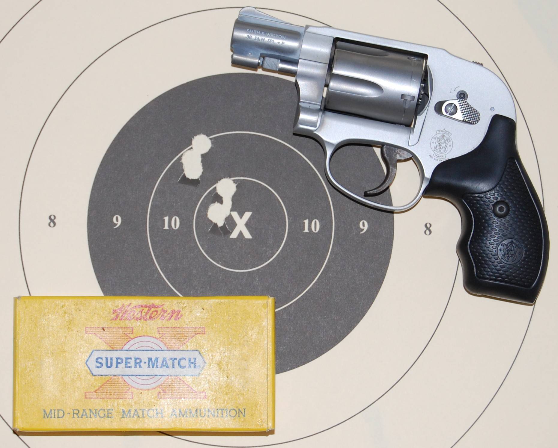

The second picture is the same gun and same type of target but using the old, faster Western loads. Note the perfectly round bullet holes, just like we expect from wadcutter ammo.
The third picture is two groups on the same D1 target using each brand of ammo. These are slightly higher quality targets so the tearing is slightly less evident in the Fiocchi group. However, the difference between the two is still obvious. The old ammo works in this gun and the new stuff doesn't.

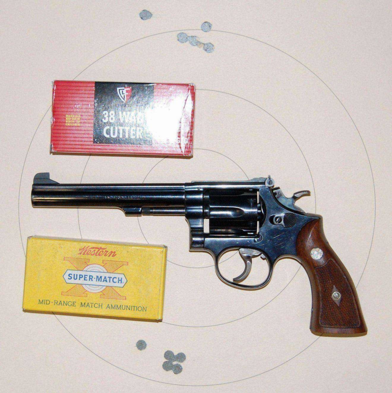

Here I went straight to a D1 target and fired two groups using the M14 as shown in the picture, below.
Clearly, the longer barrel of the M14 allows for enough additional bullet velocity (and, thus, rotational speed) to very nearly stabilize the bullets when using the Fiocchi ammo. Note the slight elongation of 2 of the bullet holes – the 1 on the far left and the 1 in the center of the line of 3 at the bottom of the group.
The old Western ammo, though, provides perfectly round holes, as expected.
