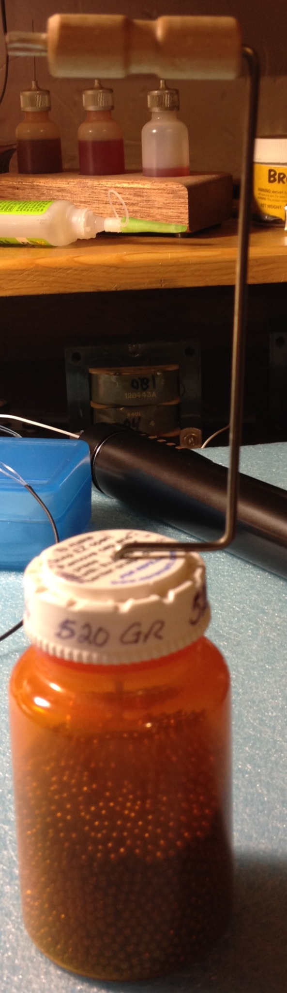

echoindia
Posts: 11
Joined: Mon Feb 27, 2012 3:12 pm
Location: Boston
Post by echoindia »
I have used this trigger weight successfully for several years. It is made mainly of a medicine bottle, some #9 birdshot, a length of wire clothes hanger and a dowel. I brought it to my local post office at a quiet time one afternoon and the clerk was nice enough to adjust the weight to 520 grams. It ain’t purdy, but it works.
