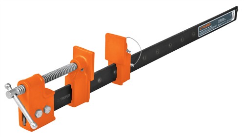

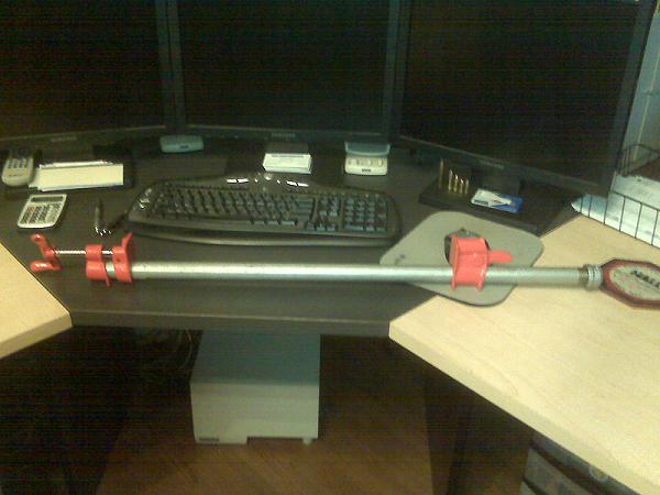

You can slightly modify a parallel or pipe clamp to fit your gun as a spring compressor.
parallel clamp.jpg (17.07 KiB) Viewed 1433 times
pipe clamp.jpg (47.8 KiB) Viewed 1433 times

Like many others, I use a modified sash-cramp - works fine :)
