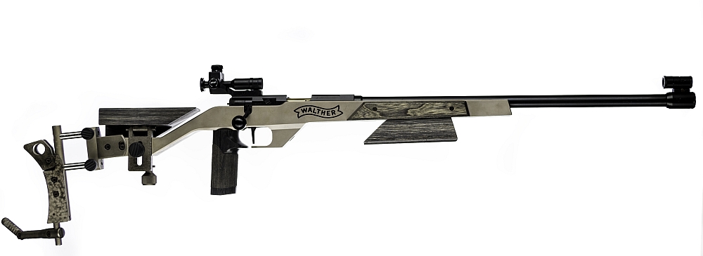

For converting the Walther KK300 and KK200 from left to right you only need a new right-hand grip. If you have an early KK200 with the simple wooden "post" grip, it is already ambidextrous (see picture). The actions itself are already right-handed (if you didn't order a left-hand, left action version, which cannot be converted to right)
The 300 cheekpiece can simply be turned 180 degrees and put in again, with some more possible variations, as you surely know if you own one. The 200 cheekpiece can be unscrewed and turned for rh shooting.
Walther KK200
Walther KK200
