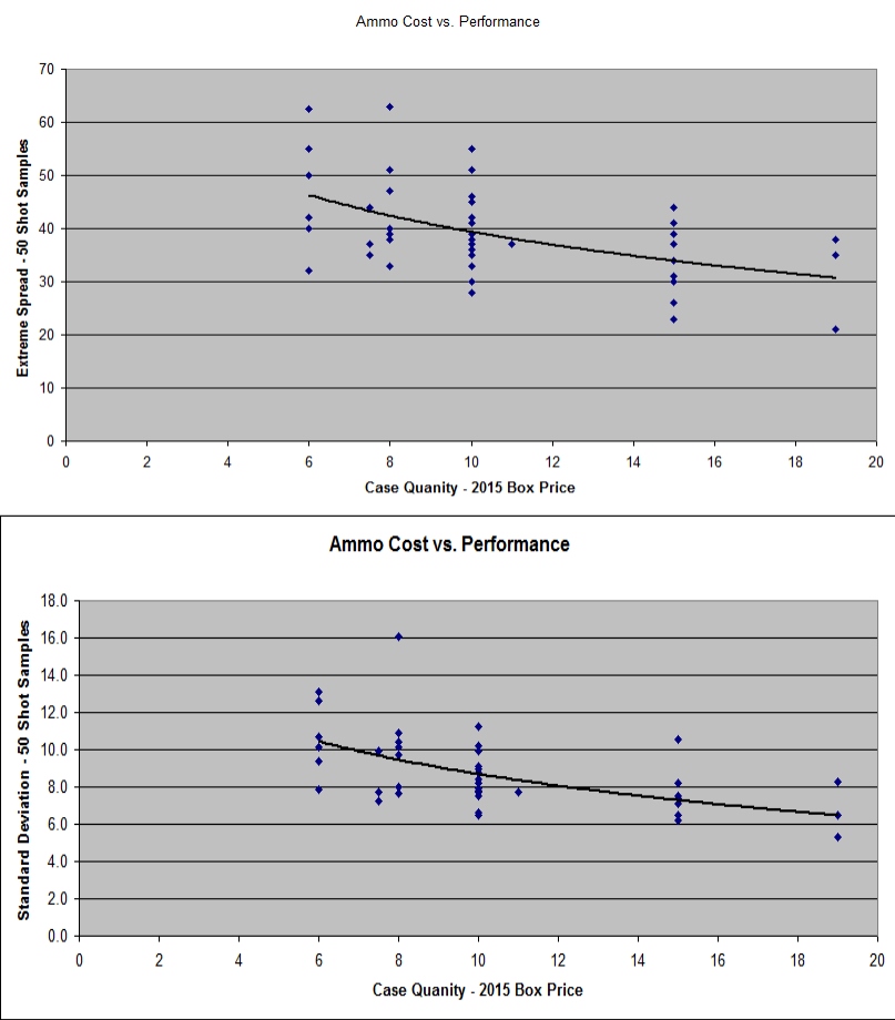

patriot
Posts: 272
Re: Ammo question
Post by patriot »
As they say, a picture (or two) are worth a thousand words.

I'd suggest you find the best ammo you can, low ES and SD, then tune the rifle to that ammo. Isn't looking for ammo that shoots well in an untuned rifle then tuning it a sub-optimal approach? It might make sense for selecting a brand (Eley, Lapua, or RWS) that matches your chamber, but beyond that... Just as selecting ammo that shoots well out of a rest rather than the stock you will be using would seem to be sub-optimal. If adjusting the receiver bolt torque can make a difference, then why isn't the stock a critical part of the system?
Bottom line, there are too many unknowns which result in conventional theories that are contrary to common sense. We badly need a scientific method to quantitatively establish the physical laws. Until then, find the best ammo you can. The really good stuff doesn't need a lot of tuning and will likely shoot well in your rifle.

Chronographed three lots of Tenex today - 50 rounds at 100 yards in prone position with my wrist supported. One of the three lots showed good performance numbers and the other two were average. But the good one's published velocity was way low. The other two were on their published numbers. The 54.30, however, didn't want anything to do with the Tenex. Perhaps the 16 1/2 twist was the cause. Some very good RWS R50 grouped OK, but a run of the mill lot of CenterX shot the tightest groups (used these two as controls and they were shot last when the wind had increased).
Mark
