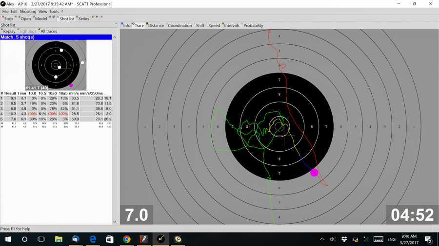

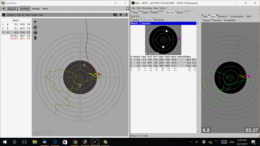

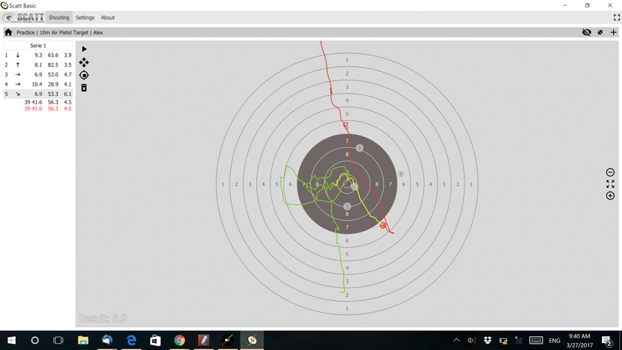

Dear friends, here are a few brief clarifications about the new SCATT Basic trainer in order to relieve the confusion.
1. The Basic, despite the lower price, is built to the highest quality standards, and offers accuracy unsurpassed by any competitor, just like any other SCATT trainer.
2. It supports dry-fire and live-fire (live-fire only with air and .22cal)
3. The main difference with other SCATT systems is the simpler software. Other systems run on SCATT Pro software, this system has its own SCATT Basic software.
4. Unlike a few people claimed above, the Basic software does offer a complete recording of the aimpoint trace (trajectory) before and after the shot, along with several other important functions, namely: Shot values, Timing of aiming, Aimpoint speed data, Printing reduced scale targets, etc.
5. The Basic software supports 12 different targets for various distances (10m-50m), while the SCATT Pro supports over 90 targets for anything from 10m Air all the way up to high power.
But in simple terms, the Basic offers the most important core features of the SCATT Pro, the ones that help you objectively record and review your aiming process. But, in comparison with the SCATT Pro systems, it cuts down on some analytical functions where the recorded data is compiled and processed to be shown in other forms, like the 10 and 10.5 ring percentages, absolute 10 and 10.5 ring percentages, acceleration just before the shot, the analytical graphs (distance, coordination, shift, speed), etc.
A few comparative screenshots are attached to show the difference. More details can be found here: https://scattusa.com/collections/scatt- ... ire-system
