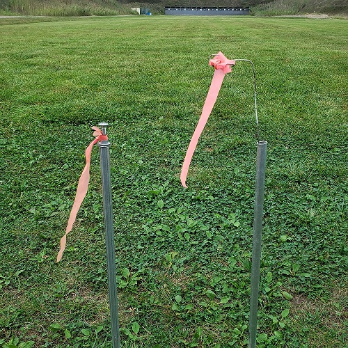

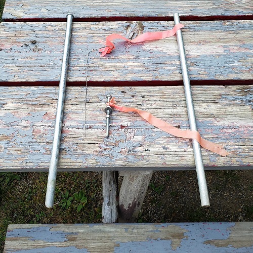

We use 1/2" electrical metal conduit (EMT). Available at home depot etc. for under $6 for 10 feet. Cut to desired length, we cut in fourths. The tubing goes into the ground easily. A long bolt with washer and nut will drop down the center and then can pivot without falling out. We also use florescent flagging tape for the flag.

I forgot that we started using cut up hangers. Here are some photos.

About the hanger type wind flag.
Does the hanger material reach to the ground? It does look like in the top pic, but in the bottom pic it does not look like it will.

Actually it usually rests lower. In the picture it is resting on the dirt in tube. Being hollow the tubes collect dirt and have to be cleaned out occasionally.
