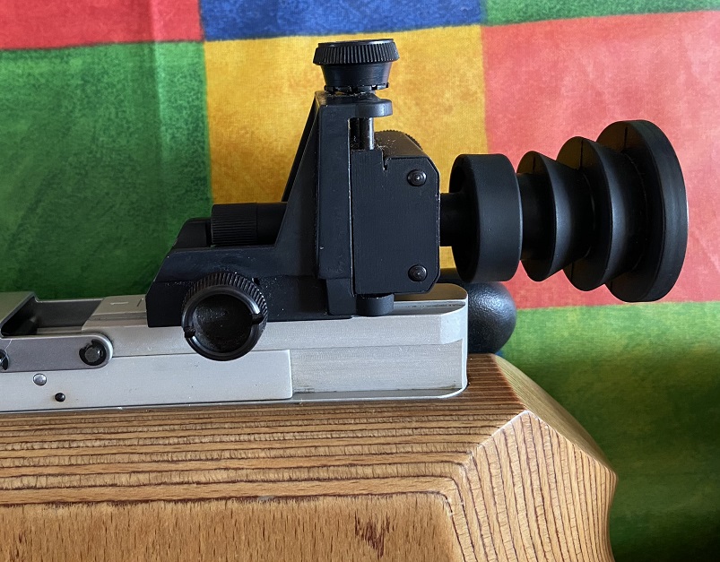

Photos might help us, but most likely a mismatched sight set. You are right that adding a riser to the front will move your shots in the correct direction. About 2mm would barely get you to shoot 10s then a few more mm to get you in the center of your rear sight adjustment range.

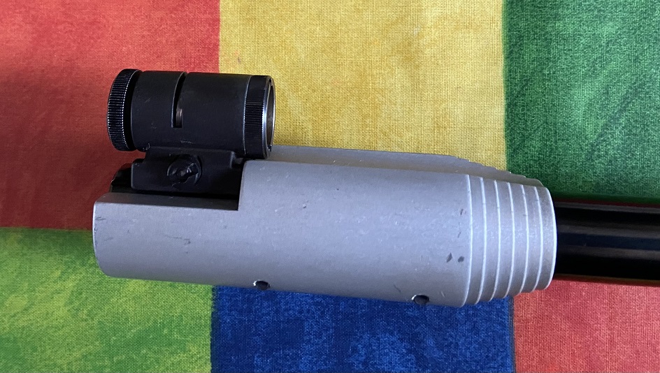

Photos of the sights here
The foresight has a perspex insert with numbers 3 above 8 (I guess refers to 3.8mm aperture)

Its probably designed to have a short riser in the front, I find that the sight globes often come much shorter and require a riser even if none is used in the rear, if the rifle is functioning correctly and grouping properly, I would say you're probably okay. One thing i've done and helps, is to adjust my rear to the middle of its travel, then place the rear and the front on a flat surface and compare their heights. I find that if I even them out usually this will net a slightly low POI that can be adjusted for with further riser fine tuning or just clicks if you're lazy like me. I've never personally tested to see if any of my rifles are accurate without risers as I pretty much require them to be able to look through the sights so YMMV.

I'm not a FWB expert, but those look like FWB sights of roughly the right vintage. What size is the tunnel? Early FWBs took 16mm inserts, then 18mm, and up to 22mm 20-25 years ago. If someone replaced a 22mm tunnel with an 18mm, that would lower the tunnel, possibly enough that the rearsight can't cope.
Apologies if you have done this already, but do check the muzzle weight is mounted properly and not bent. Are you sure the tunnel is mounted securely; it's probably nothing, but the back of the tunnel looks like it's catching on the muzzle weight. Ditto, check the insert/element is central in the tunnel, not biased to 6 o'clock.
The 3.8mm on the foresight insert is indeed the diameter of the aperture. It wouldn't hurt to try a larger aperture for standing.

The front and rear sight are correct OEM sights for your rifle.
The tunnel ist mounted backwards, the insert screw should point towards the shooter, but that shouldn't be the problem.
If any magnifying lens is mounted in the tunnel, try to remove it. These could eventually be the reason for your problem.

Answers to some questions raised. The tunnel is 16mm internally (a bit more as the insert measures 16.1) and there is no magnifying lens in it. The sight was this way round when I bought it but I have tried it both ways round. It has made no difference to the POI however I wouldn’t expect it to. The sight is not contacting the muzzle weight.
What is the purpose of the screw the other side of the insert screw?

I wonder if a previous owner swapped the foresight tunnel for an older pattern.
As suggested above a slim (say 4mm) raiser block under the foresight should raise it enough that you can zero the rearsight comfortably. Alternatively buy a new foresight tunnel, either 18mm or 22mm; this needn't be an FWB product, both Gehmann and Centra make tunnels compatible with FWB rifles. 18mm and 22mm foresight inserts are much easier to find than 16mm.
The screw at the other end of the tunnel would be for a spirit level, lens, or anti-glare tube/sunshade. These aren't allowed under ISSF 10m rules, but FWB fitted the same tunnel to their smallbore rifles.

Ot really looks to me that somebody has the action out of the stock and didn't get it put back in correctly..... The rear metal is sticking up above the wood a small bit, and it should be a bit below the stock...... Perhaps loosening the screws and moving the action around will resettle the action. I believe it is being held up too high

Lukas90 wrote: Tue Apr 26, 2022 3:42 pm The front and rear sight are correct OEM sights for your rifle.
I'm not so sure. I think the rearsight is for a 601, and that the 600 & 601 rearsights are not necessarily 100% interchangeable.
