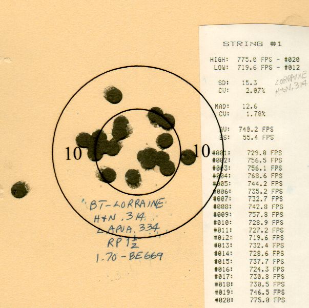

Most of the Euro-Guns have 0.314" groove diameter barrels with 1:18 3/4" twist.
You can get three inch groups at 50 yards with GOOD BULLETS.
The best I have tested are the H&N 100 grain Greased HBWC.
1.70 grain of Bullseye works well.
The test target is a Pardini HP barrel fired at 50 yards.
Our USA Ten Ring is 3.36" diameter.
