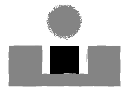

Firstly I was intrigued by the 570+. If it is a reality rather than an aspiration I would leave my front sight alone.
If not there is an argument to not move anything, but replace the sight with one at least 5mm wide and of an appropriate height. Walther replacement front sights are obtainable up to this width.
Personally I use a custom front sight 6 mm wide and a little taller than normal. For my eyes this provides a front sight picture that matches the apparent width of the black on the target at 10 metres and is a pleasure to view as a result of its size.
You may have to make an elevation correction with a taller sight but you will have a sight picture that reduces eye fatigue and allows a symmetrical appearance which is easier to reproduce.

- 3BB6884A-9AD7-43BE-9A08-B69D62CAA0AD.gif (3.56 KiB) Viewed 3104 times

The most common recommendation is that the visual width of the front sight should roughly match the apparent width of the black, just as shown in Deadeyedick's picture. If your arms are atypically short or long, that's going to have a big effect on the effective width required. To maintain the maximum amount of symmetry in the sight picture, you also want to keep the size of the side gaps roughly equal to the gap below the black:
