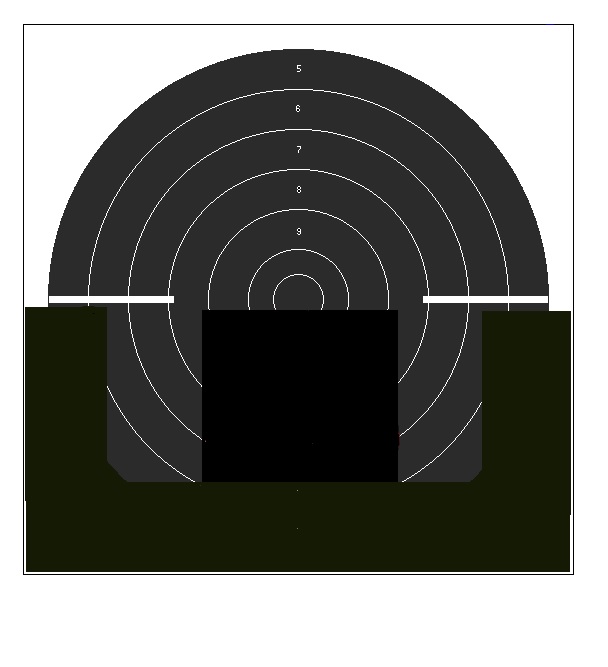

Posts: 1719
Re: New(ish) shooter with questions on sights
sight picture 70%.jpg (12.32 KiB) Viewed 34562 times
Sub 6 o'clock sight picture.
It does not matter what colour you put on your fore sight, because as we shoot from
an under cover shooting bay and and not in direct sunlight the sights just appear black.
Note/ The foresight is sharp and very black, has a square appearance and is about 70% the t width of t he target.
The rear sight is very slightly blurred and has a little grey tinge.
The light gaps under the target and on the side are equal.
The target is blurred and grey.

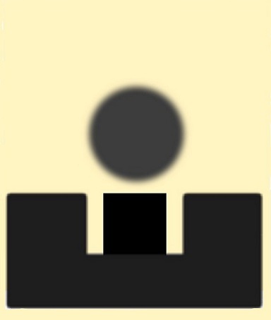

Posts: 1719
Rapidfire is nearly centre aim, just low of centre to see ther aiming marks.
Note/ The rear sight is now a lot wider the the sub 6 sights.
This allows a quicker pick up of the sights for the shorter times to shoot.
