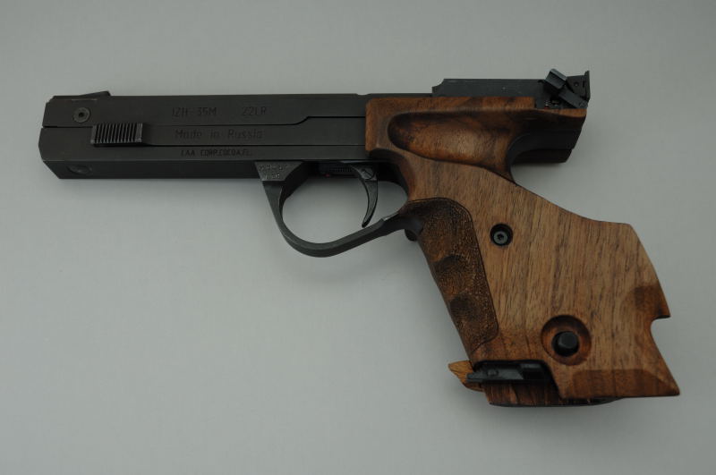

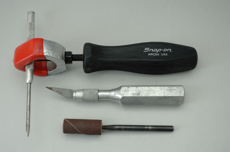

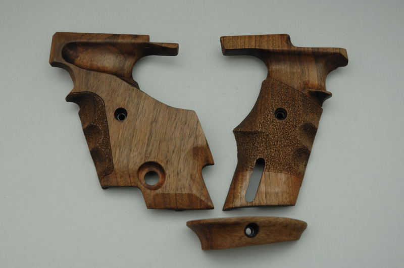

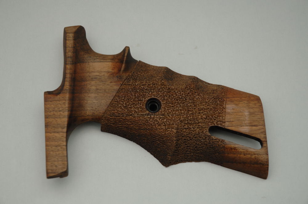

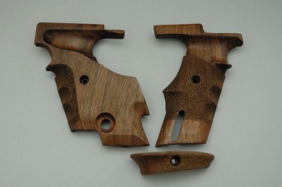

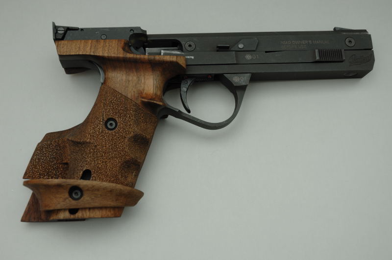

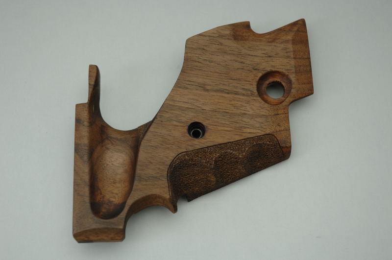

Finally found some time.
The grip on my IZH is modified factory. At the time I did the fitting I didn't have the funds for a morini, rink, etc.
I read many articles about grip fitting and tried to use as much info as I could to get a good result.
The main tool I used was the sandpaper roll mounted in a die grinder. A Dremel will work as well. Working from back to front I cut/checked, cut/checked until I had something that I thought was comfortable. I took things slow, small adjustments over three nights. You must be careful to not remove too much wood, as the grips are thin in certain areas. After I felt I had a decent form I outlined the stippling area with an X-acto knife by lightly scoring the wood. The stippling took a great deal of thought. After having shot Anschutz free rifles as a kid, I knew that I wanted the grip to feel similiar. I tried many methods, until I stumbled upon the pick. The stippling was done by repeatedly striking the grip with the pick in the handle. As you might guess, it took quite a while to get the whole surface.
I am happy with the outcome, especially it being my first attempt.
I hope this helps!
John

Post by Tzed250 »
More images:

The grips look great, Good Job.
I will be using your pick technique to finish a grip I have been working on, but it looks time consuming, maybe I will nail a few nails close together on a piece of wood and use that to tap the grip on the major areas.
