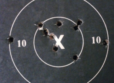

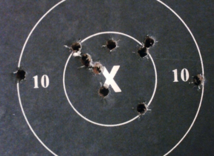

Post by milevsport »
Have you looked at Pardini .32? Pardini USA is getting ready to launch a .32 ACP version. The ammo showed really good tests and is cheaper to reload or buy. Because of the shape it is also easier to feed in the chamber, comparing to .32 SW. I shot the prototype at Camp Perry and won the Rapid Fire match of the Center Fire day. Great gun with not much more recoil than the .22 LR Pardini.
Check it at www.PardiniGuns.com

Do you use a HBWC bullet in the 32ACP?
