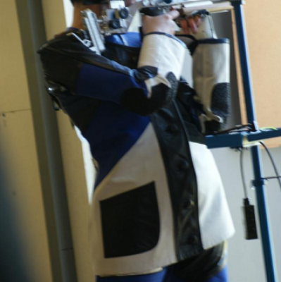

Sent some photos to Gary Anderson this past weekend for his opinion on what the ISSF is meaning about this rule.
Below these photos is Gary's response on what he thinks ISSF will rule on this jacket (a KT Adventure). If you have jacket seams that look like these, get ready to repair/replace.
(And yes, it's a new jacket ... started shooting it at trials in Feb)
And my own $0.02 is that this seam offers no support.........
Also note that this seam passed stiffness EC at Winter Airgun a week ago.

Post by Abi »
Hmm...
On the Monard Super, they made that section on a diagonal. The smudge in the suede from my elbow is about 1 to 1.5 inches above the seam. "Maybe" I got lucky...
I wish they would have attached some diagrams with the rule changes. Thank you for posting your photos and the info you have.

This is a brand new Champions Choice CC801xxx mens jacket received last Thursday (12/6/2012). Put it on last night at practice, and bummer ... it's gonna be illegal too.
Used a cell phone camera and also my jacket ruler ... the top of the yellow is at 70mm, so this was 4.5cm from the tip of the elbow. Note the start of the sorta diagonal seam near the button. The zero on the ruler was right on the seam.

Abi wrote:Hmm...
Abi
Abi ... the smudge is only the "contact" where jacket meets jacket ... if they measure from the tip of your elbow, it might be right on the seam ... the worrisome part is the 6-8cm measurement Gary noted.
Have someone get a ruler, put the zero on the seam, and see where the tip of your elbow is.
"MAYBE", you get lucky.
This is a really bad rule in that unless they have you mount your rifle at EC with all gear on you really cannot tell. It's gonna partially be determined on what your stance is. The jacket may pass on one person and fail on another. Chaos in EC. Or better yet, chaos on the line.

One of the local high schools sent over a Monard Jacket that has a diagonal seam. (GREAT FIT!) Seemed to clear with an air rifle, but the heavier smallbore rifle moves the elbow down.
[sarcasm]More "Technological Doping" I guess[/sarcasm]
So I learned something today ... you had better test with your heaviest rifle.

My Wifes Monard with a diagonal seam was checked at the point of the elbow and in relation to the seam at that point. Hers was just legal (and I mean JUST!) and she got her tags and cert but its so close she's having it modded any way as we know she is sure to be pestered by range officers checking it and its just another thing to "F" up a shoot and is not worth the hassle.
