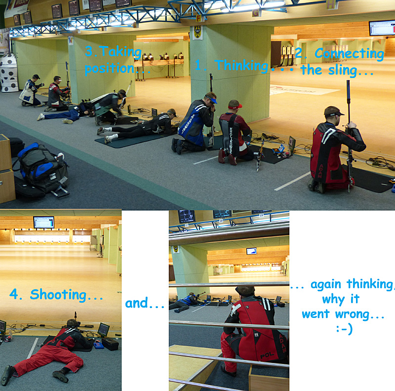

Here you have some examples from the World Cup 2013 in Munich, photo taken today, so really up to data.

Nice pictures but they don't tell you how the shooter got into position. In some cases you can't even see what that position is - but I do know it varies quite a lot from shooter to shooter, at club or elite level.
I'm more like Rutty in that I lay down first then hook up. I do what you shouldn't do and move my elbows around to get in the right position relative to my scope. The most important point though is that however you get there, your position must be 100% consistent and your NPA must be aligned correctly with the target diagram.
Rob.

Even worst, you do not now what they are actually doing there.
Sorry, just kidding. Yesterday we had again such "tarmps atack" on the range... I hate this, it is against the rules, and nobody takes care...

Grzegorz, what rule does having a blanket or similar to keep warm break?
After going through the manual the only one I could find is 6.7.2 and since all competitors have decided to cover up there can't be an unfair advantage unless your a complete numpty and decided to tough it out. What's to say that the competitors didn't approach the officials and discuss the idea?
Rule 6.7.6 won't apply as a blanket or similar covering is not a piece of clothing, well unless your unfortunate enough to be homeless :-(

KatoomDownUnder wrote:After going through the manual the only one I could find is 6.7.2 and since all competitors have decided to cover up there can't be an unfair advantage unless your a complete numpty and decided to tough it out.
That numpty would appear to be Sergei Kovalenko in the top photo.

I hook up while in position similar to photo above with shooter shown in firing point H. Then starting well back from scope, lie down & then crawl forward a little bit to get jacket & pants into a consistent position.
