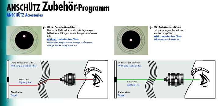

I understood from the AGH catalogue that a polariser also diminishes the effect of heat shimmer/mirage.
Posts: 2091
BobGee wrote:I understood from the AGH catalogue that a polariser also diminishes the effect of heat shimmer/mirage.
Given that's caused by heat radiating from the ground kin front of the target, I'm not sure how a polariser would help. It can tone down glare in very bright light, but not correct mirage.

Turns out it was actually the Anschutz (not the AHG) catalogue (apologies for the poor image; better image in PDF download):
Anschutz Katalog_2007_Matchprogramm.pdf
(65.24 KiB) Downloaded 132 times
