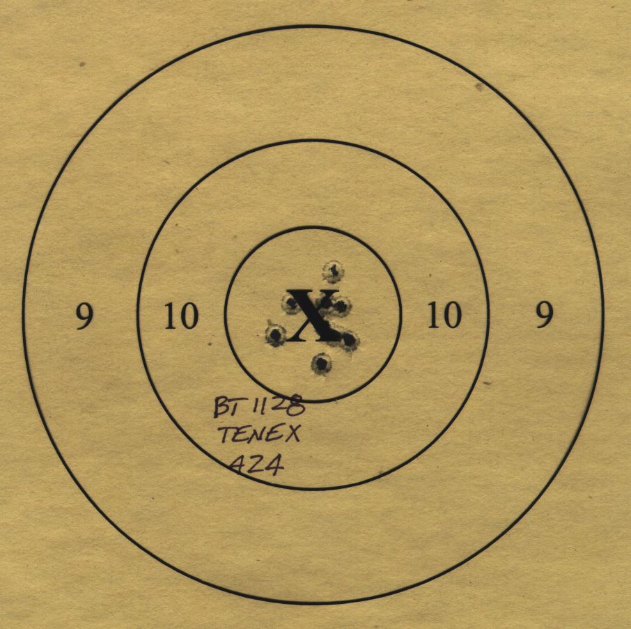

fc60
Posts: 759
Illustration of a Ten-X group.
Post by fc60 »
Fired at 50 yards from a machine fixture.
kkayser
Posts: 14
Joined: Tue Mar 05, 2013 11:09 am
Re: Illustration of a Ten-X group.
Post by kkayser »
fc60 wrote:Fired at 50 yards from a machine fixture.
I assumed it was 5 shots in the X ring. But, what is the size of the ring?
GOVTMODEL
Posts: 649
Location: Rhode Island, USA
X Ring diameter...
Post by GOVTMODEL »
...IIRC, is ~1.6 inches.
kkayser
Posts: 14
Re: X Ring diameter...
Post by kkayser »
GOVTMODEL wrote:...IIRC, is ~1.6 inches.
Any shot touching the ring is considered "in". So if the ring is 1.6" and bullet diameter .22 inches, two hits 1.82 (1.6 + .11 + .11) inches center to center would be considered in the X ring. Therefore, an X ring group is equivalent to a 1.8 inch (approx 1 7/8") group.
trulyapostolic
Posts: 105
Joined: Sun Mar 20, 2011 1:34 pm
Location: Elkhart, IN
Post by trulyapostolic »
Looks like 10 shots.
