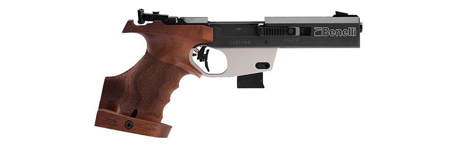

It's a good looking pistol. This is a pic of the latest 32, they have added a lot of adjustment features but removed the scope rail.
