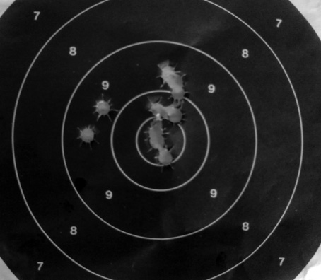

would like to greet and share my experience with charging of 9 mm. GT9 Pardini for a 6 ":
Bullet: 25% lead, 75% linotipo
Cast: LEE mold 358-125gr. dia.358
Bullet sizin & lube: 357 "
Weight 119-120 gr
Powder: 6.1 gr Hotgon HS6
Introduction: 5mm
No crimp.
Weight 119-120 gr
Introduction: 5mm
No crimp.
Is that target done at 25 meters? And off the bench or out of a vise or ransom rest? What's the overall largest spread?

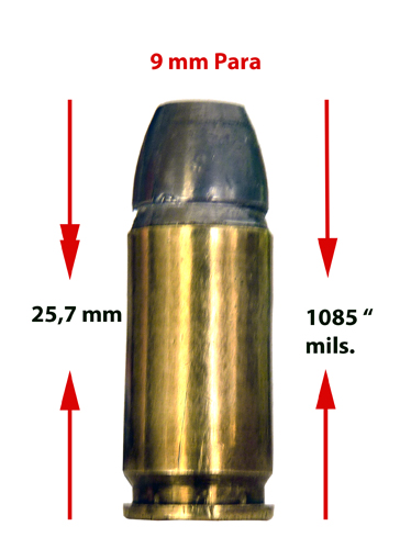

paobo42
Posts: 3
Joined: Tue Dec 02, 2014 1:11 pm
Re: reloading for Pardini GT9 9mm
Post by paobo42 »
I answer all the group, is to support. The bullet alloy are 75% and 25% linotype lead. (With an alloy 50% to 50%. With 100 shots were traces of lead in the barrell). This is my Pardini GT 9 6" 356 "caliber, reason why swadget & lube on 357".

Post by dragon »
The pic seems to show the Lee 358-125RF bullet. This is the bullet which I tried but had to load it to under 1.000 to allow it to chamber, due to the large diameter of the flat nose and the long bearing surface. The short chamber of the CZ and Pardini barrels would not chamber the round unless it was loaded to about 0.993. At a length of a little over one inch it was hitting the rifling. What am I missing here? Is my barrel different? The CZ forum lists the max overall length to be 1.000, and the chamber in my Pardini is the same length as my CZ. My loads with this bullet did not feed well at the short loaded length and sized .357.
