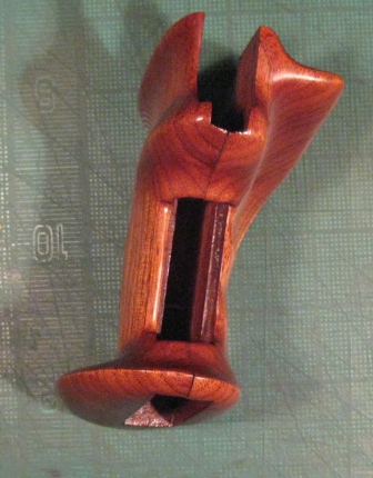

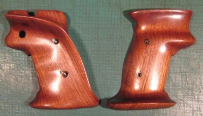

Greetings.
I have a mystery grip set. Please help me determine what it is intended to fit. I do have a guess - that it is for Hi-Standard .22LR pistol but it is only a guess as I do not own one...
Your help will be appreciated.
Greg

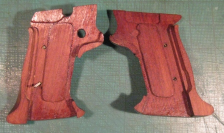

I agree with Sa-tevo. Looks like they will fit a Smith & Wesson Model 41. The 41's use two long "cross-screws" to pull the
right and left panels towards one another, thus securing each one to the frame. Each screw is about 1 1/2" long. Both of
the holes in the left panel are just through holes; the screws simply pass through them. The other two holes in the right
panel have threaded components (nuts) in them for the screws to engage into. On all of the High Standards that I've seen,
each grip panel is attached to the frame separately. To install one, there's a blind hole near the bottom of it that's seated
onto a pin in the frame. At the top, a short screw is inserted into the single through hole in it and engages a threaded hole
in the frame. Installation is the same for both the right and left grip panels.

Yes - sure looks like the S&W Model 41 grip. Thank you all for help.
