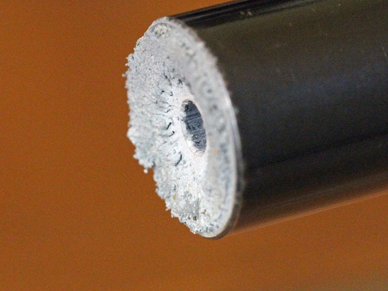

I echo Tim's comments on cleaning the crown, it's undoubtedly causing the issues you're experiencing. The attached picture is from rimfire accuracy website and shows fouling on the muzzle of a 2013 after about 1500 rounds! Yours must be in a real state by now! The full link is here:
http://www.rrdvegas.com/the-2014-season.html
After you've cleaned the crown, if the problem still persists, then I'd clean the bore with VFG blue paste and then lots of oil to wash it out. It will remove any lead in the barrel by polishing it out, lead is very inert so chemicals won't dissolve it. I had similar problems with an 1813 that turned out to be caused by a pitted barrel that I only discovered after I'd cleaned it for three hours with the VFG paste.
If after all that you decide you do need a new barrel then the only two gunsmiths I could find willing to fit a rimfire barrel in the UK were Robert Nibbs (as mentioned above) and Steve Kershaw, nobody else was interested. I've had a benchmark barrel on order from the states since February and it doesn't look like it'll arrive any time soon.
Good luck and show us a photo of the crown once you manage to get the tube off, be advised it may need to be soaked in solvent to loosen the crud before it comes away.

Mine didn't initally look anything like as bad as the photo earlier in this thread, until I looked down the extension tube. It was as if there was a lead cork stuck in the tube!
This took quite a bit of scrubbing to get it out, but seems relatively clean now. Hopefully, that should steady up the shots a bit.
