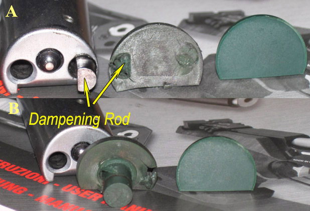

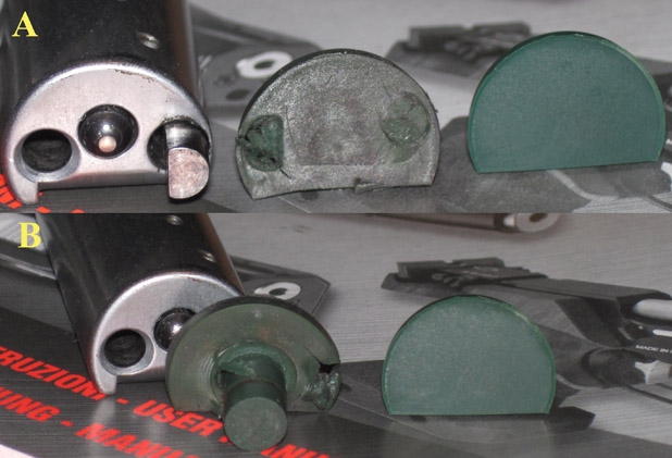

I happened to use a bright light to check the condition of the rear shock absorber in my Pardini SPBE. I observed a "small" crack and thought it prudent to order and replace. The manual does not indicate how often the absorbers should be changed or even how to do it, but the "small" crack indicated a change was needed. Changing the unit is straight forward.
Just push out the old shock absorber out from the rear of the frame (grip must be removed). I used a 1/2" dowel to install the new one by adhering it with some grease to hold it on the end a dowel; after a few tries I got it lined up correctly.
In the attached image you can see the "small crack" I saw (Fig. A) and the following image (Fig. B) shows actual damaged done to the absorber. Needless to say, boy am I ever glad I checked. I would hate to hear what the bolt hitting metal sounds like.
I bought the pistol in late April 2014 and estimate that I've put ~8400 22 lr. rounds through it (all standard velocity), plus another 2300+ 32 ACPs (~850 or less fps). Since both barrels use the same frame, the shock absorber does double duty. I consider this normal (maybe even light) use for a BE shooter. Considering the popularity of this pistol among BE shooters and the recency of its availability in the U.S., I suggest every owner shine a strong light down the frame to examine the condition of this important part.
Most damage to the absorber is done by the rear of the dampening rod (part 770, the semicircular extension on right of real bolt), which is only on the 22 lr barrel. The lower figure (B) shows the back of the worn absorber and actual the extent of the damage. Scary. Happy Halloween, dipnet

Because I shoot I shoot both 22 lr and 32 ACP with my SPBE, Alex Chichkov recently confirmed that I should remove the dampening rod (part 770), rod pin (769), and the dozen or so O-rings (771) that occur behind the dampening rod in the in 22 lr bolt. The dampening rod is not found on the 32 ACP bolt. The clear cause of damage to the rear recoil absorber was caused by the dampening rod slamming into the rubber absorber (see photo).
The dampening rod is easily removed from the 22 lr bolt by punching out the retaining pin (the one closest to the rod) with appropriate punch on a bench block. After you remove the rod, pull out the first 2 or 3 O-rings using the punch and most of the remaining rings can be gently tapped out, likely except for the last stubborn one. Alex cautioned that the rear recoil absorber should be checked annually for possible damage and replaced as needed (depending on how much you shoot). I reconsidered estimated ammo shot since buying the pistol in spring 2014 and suspect 22 lr is ~4000 rounds or less plus ca 2000 rounds of 32 ACP. Now it is easier to lock the slide back in 22 lr.
In the attached image, you can easily see where the rear of the recoil dampening rod had impacted the rear recoil absorber. Best, dipent

Dear Dipnet and Dave, after removing part 770, the recoil dampening rod, have you any indication that the rear of the bolt is slamming too hard against the back of the frame? It seems very odd, as Dave mentioned, that Pardini would leave the part in when it damages the rubber recoil buffer. Or maybe they consider the recoil buffer pad to be a consumable, as you suggest with the recommendation to examine/replace at the end of a shooting season.
How much have you or Alex fired the gun with the rod removed? Have you seen any deformation to the rear of the bolt? Any stress cracking?
I just ordered a new SP and have yet to complete the waiting period, so have not received it. I am considering the removal of part 770 when I get the gun, based on what you report from Alex.
My concern stems from a Hammerli SP 20 that I've shot for more than 15 years. I am now on my FOURTH bolt on that gun as the first 3 cracked. Clearly it was a design error. But it makes me Leary of the effects of the bolt slamming against an inadequate recoil absorber. The design flaw had to do with the thinness of a part of the bolt near the extractor, all three bolts cracked in the same place.

Re: Replacing rear shock absorber: Pardini SP BE
John,
I think the setup of the SPBE is the product of conjoining two different firearm designs, the SP and the HP. The SP has the recoil dampening rod and the HP does not. Before the SPBE, if you wanted to shoot 22rf and 32 S&WL, you needed to buy two pistols. When the SPBE was developed, they obviously started with the SP design and modified the barrel shroud to the 32 ACP and simply stuck them together. There have to be some differences between the two and an SP cannot be mated with a 32 ACP conversion kit. Maybe Pardini left the dampening rod in thinking American's might use all sorts of ammo in their guns, including high velocity stuff and the redundant system would be necessary.
I suspect Americans have done a lot of testing of the SPBE concept for Pardini.
I'll continue to monitor my rear recoil absorber and will likely keep a spare as they are easy to replace (using your 45 stuck-bullet dowel and a little grease). I've shot mine without the dampening rod and can tell no difference, except it is much easier to lock the barrel back now, which I like. I suspect other European target pistol makers would like to follow the 32 ACP example, but I believe there are laws in different countries not allowing the public to shoot military or police calibers. I had a 32 GSP and thought I could beat the slow twist by pushing a heavier bullet (98 gr.) faster to make it accurate at 50 yards, but it didn't work (and that was using Lapua brass and bullets), but I never got accuracy under the 9-ring.
