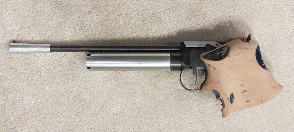

Then, I built a spare air pistol into a dedicated air pistol made to Free Pistol specs… I modified a Pardini-Fiocchi K-60 air pistol. It used a thinner diameter, .177 K-58 barrel (10mm vs K-60's 12mm) with an extended blooper tube and muzzle brake. It used a short CO2 cylinder and 20-30 gram trigger. Pictured below.
Other than the switch from PB to pellet game and a new target, all other FP rules applied. I called the game "Air Pistol Free" It allowed me to practice a light trigger game with wrap-around grip hand pressure/technique in my basement. With the smaller target, I shot about as well as I could outside at 50 yards.

Updated photos in OP above...

askernie wrote:DFW... Can I get some info on how you got that grip made? ernie
I made the grip myself from "Tuf-Fil" resin... https://www.freemansupply.com/products/
Topic discussed in posts 21-25 of this thread... viewtopic.php?f=4&t=53842&p=262069#p262069
