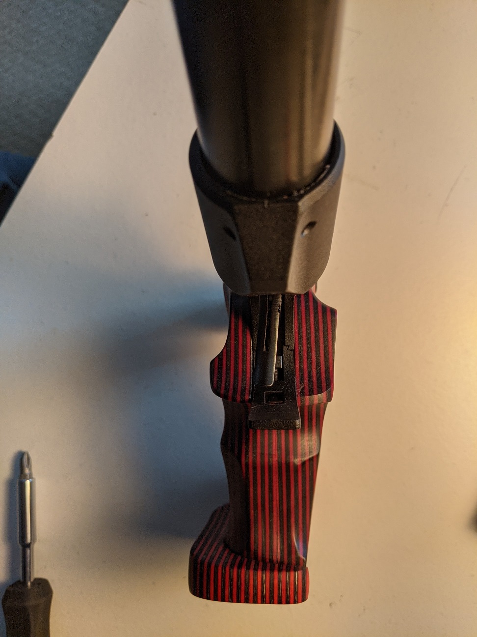

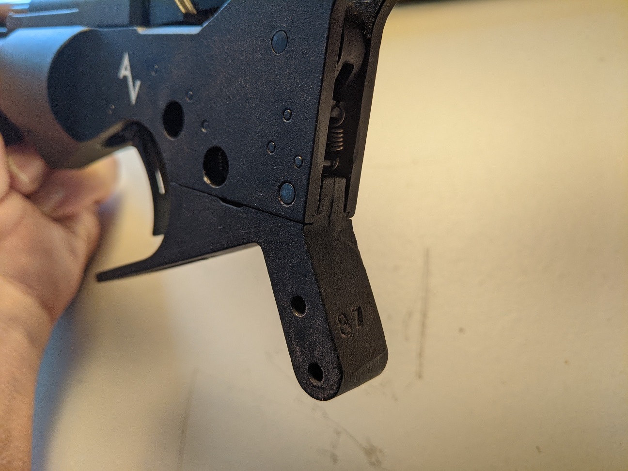

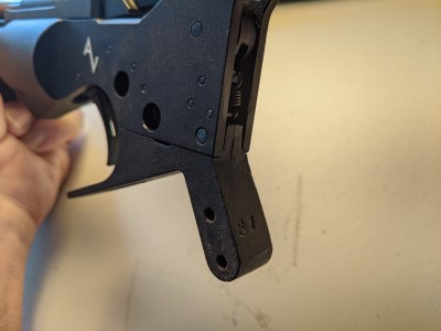

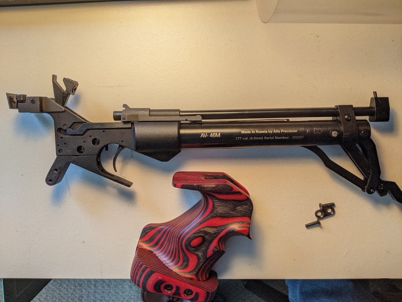

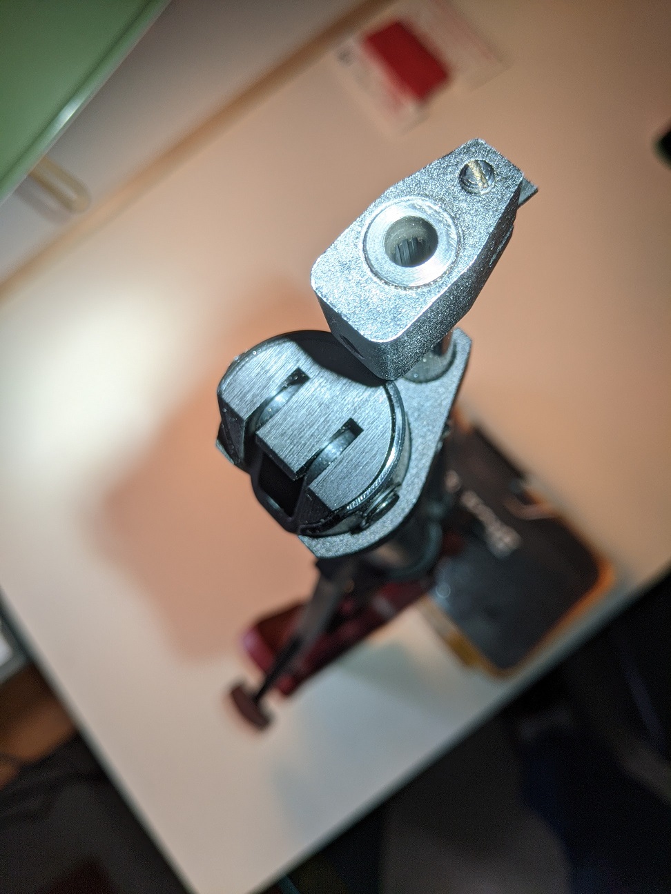

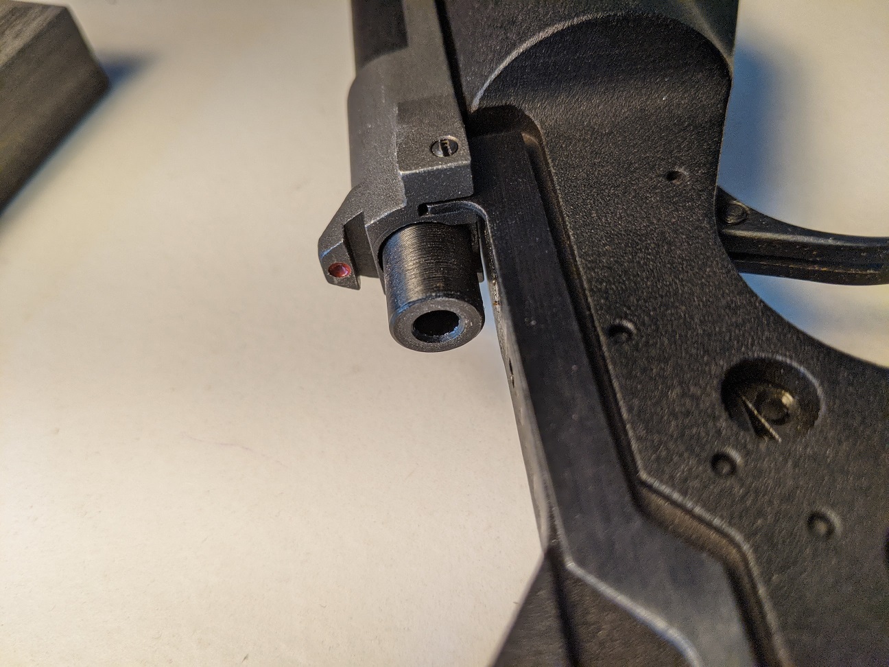

The pistol, even in its current slightly detuned state, is performing fabulously. I'm almost tempted to leave it alone for the time being. It is quite pleasing to cock it so effortlessly.
Anyway, some closeups for your enjoyment. There's a 5-photo forum limit, so it will take another post for all 7.

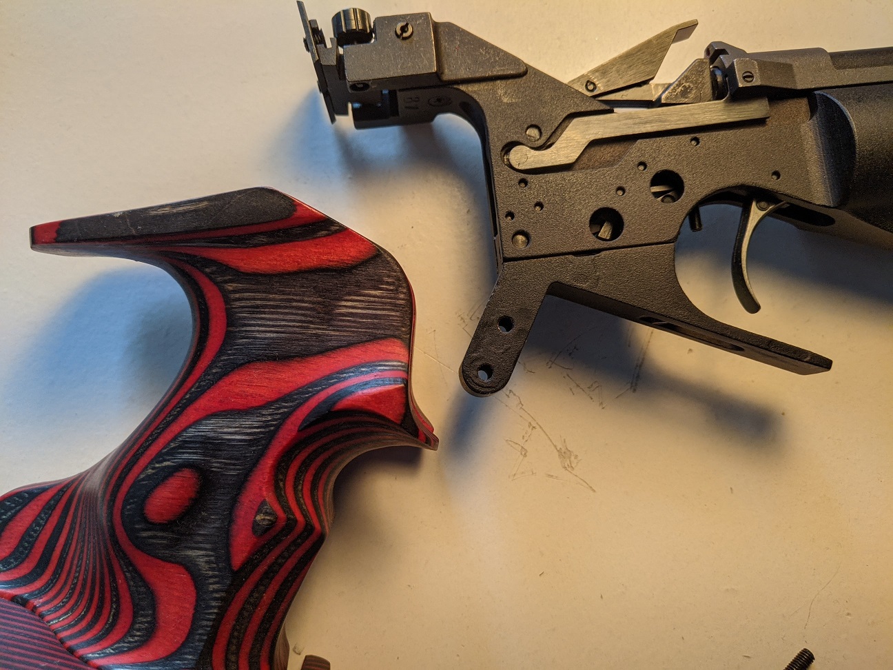

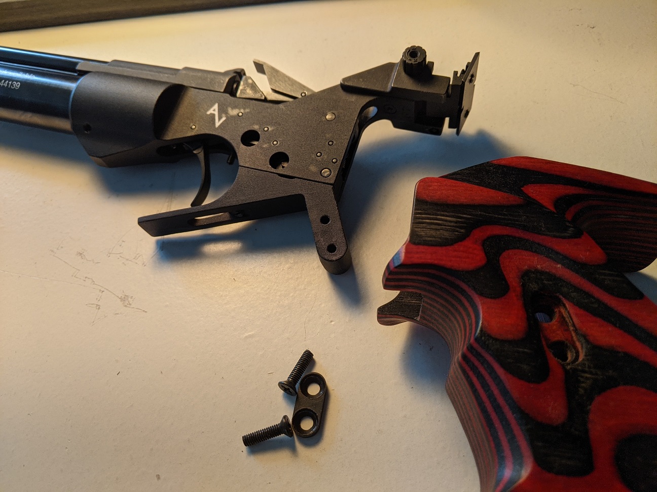

Two more shots, showing the grip mounting detail.
Do you think that standard IZH-46M grips will fit? While the laminated grip is one piece, and attaches with two screws only on the left, it seems to me that a two-piece grip will attach just as easily, albeit with shorter screws. The frame holes are tapped all the way through. But in IZH-46M photos I've found online, the screw spacing on the left seems much wider.

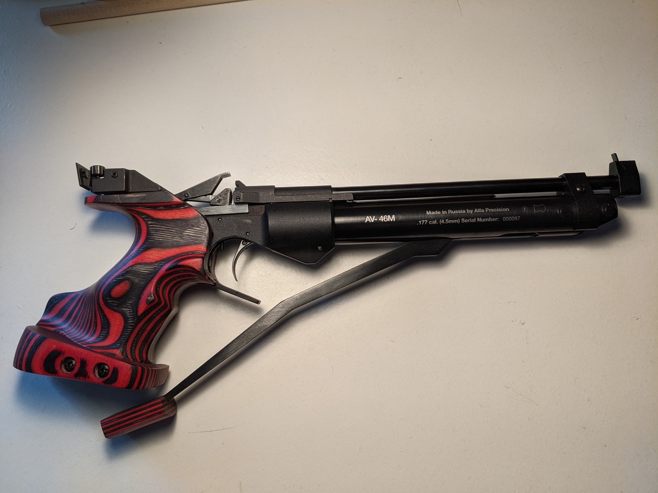

It appears it is made in the same Baikal facility, but I have no hard evidence. The cylinder is imprinted with "Made in Russia by Alpha Precision", in English, with the letter F in a pentagon and pictogram of a round-headed skirted pellet. On the other side, similar lettering says to read the manual, available "free" from Air Venturi Cleveland OH USA 44139. Except for the grip, every detail of the pistol appears to match recent-production IZH-46M units.

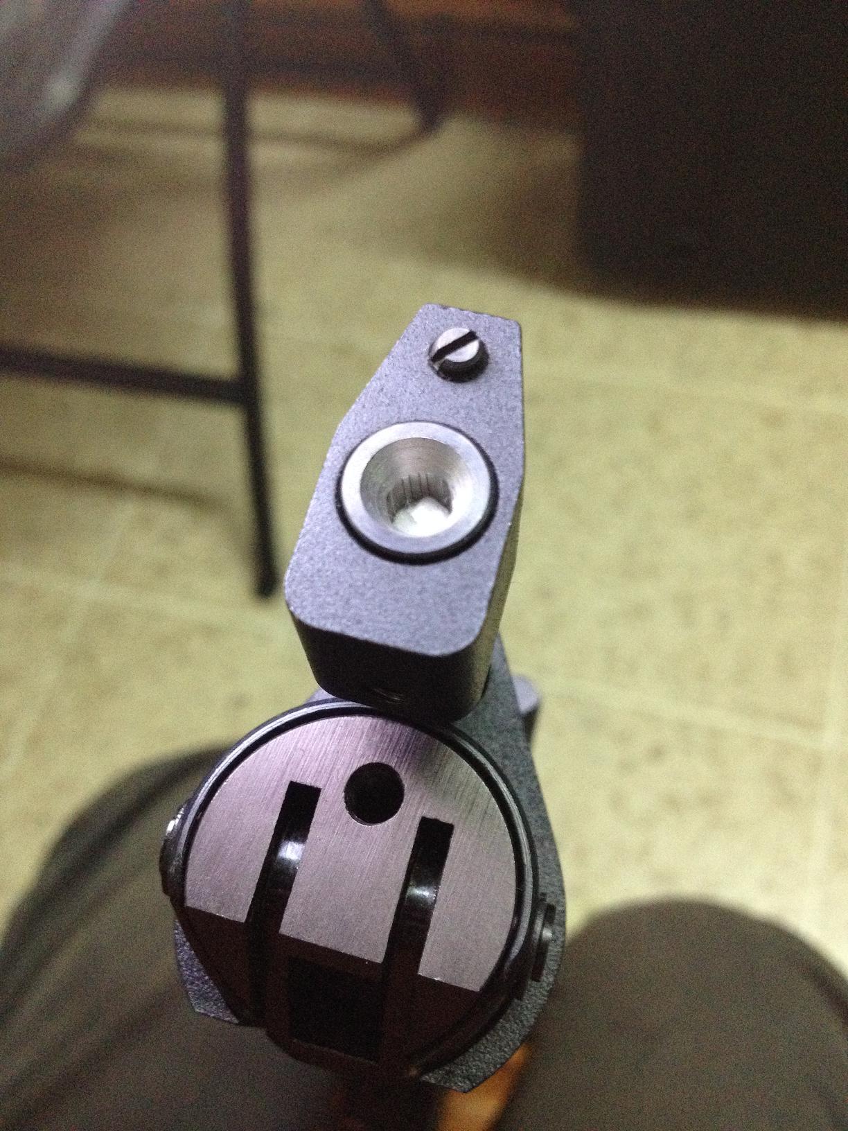

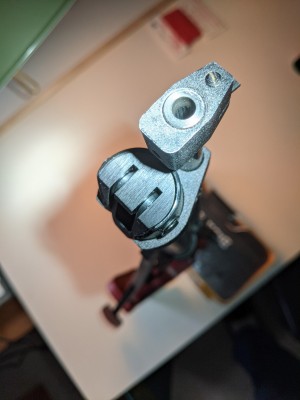

Here's a pic of the recessed crown of my old Izzy 46M. The lands and grooves of the "new" AV46 seem like they do not reach the end of the muzzle?
