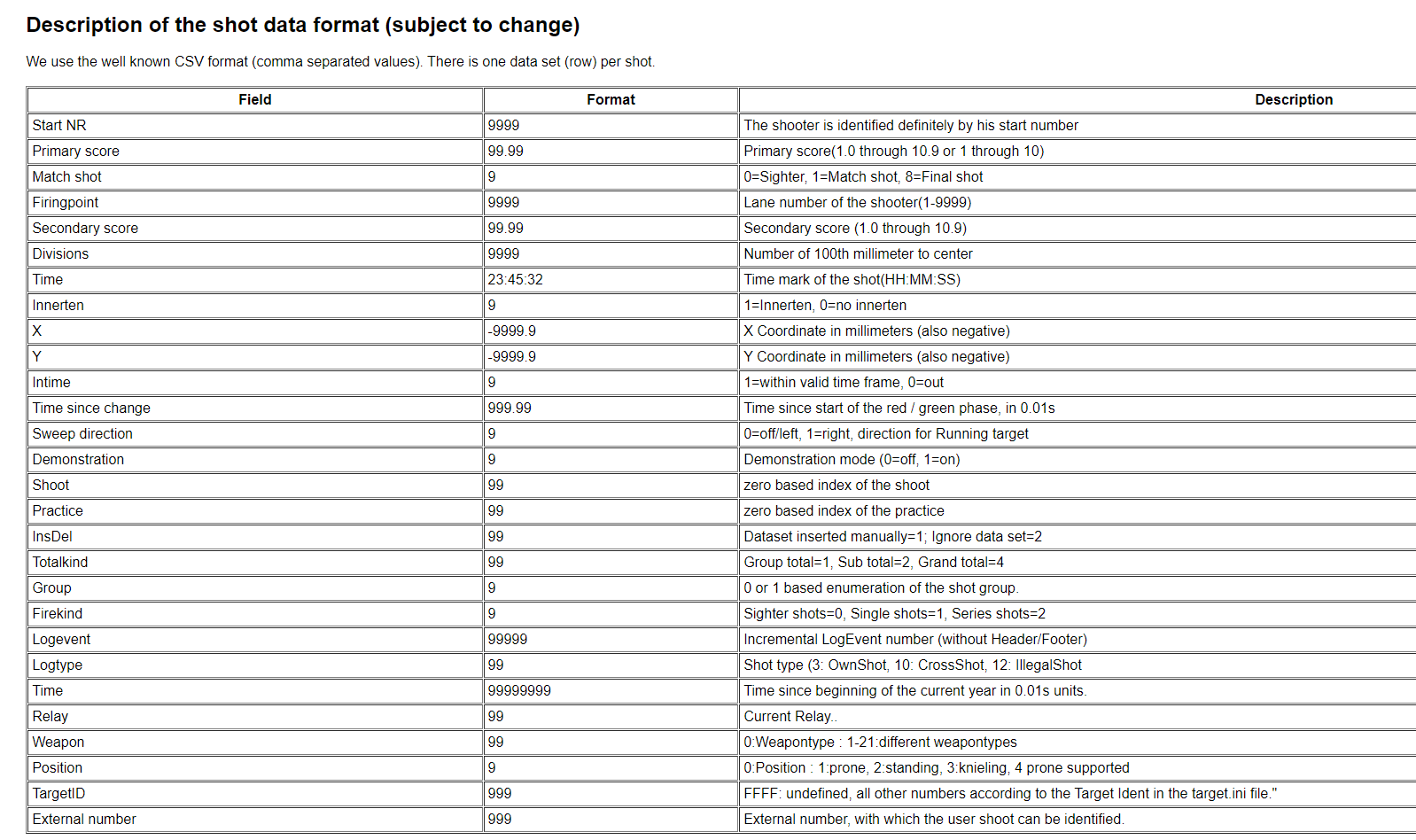

...found this thread and am really interested in knowing the result CSV file.
2 questions:
1. What is the difference between the STL CSV file and the one without STL?
2. This is from the pure (non STL) result file:
1132;10.4;0;6;0;147;17:56:23.94;1;1.47441;0.09275;1;655.35;0;0;1;0;0;0;0;0;6;3;749498394;0;0;0;61;0
What does the different column say? (0-indexed)
column 0, the start number of shooter
column 1, must be the actual score
column 2, I guess is 0 if practice and 1 when match?
column 6, when the shot was fired/registered
column 8 and 9... where the actual shot was placed? The above example is 1.47551 and 0.09275... how should I interpret it?

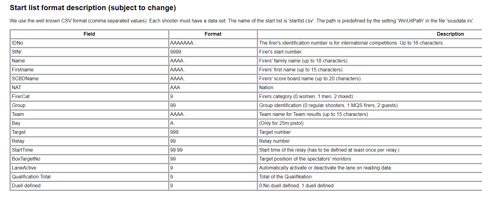

mrmsf wrote: Wed Mar 29, 2023 3:31 am ...found this thread and am really interested in knowing the result CSV file.
Shot data and start list (_stl.csv) format are documented in the help file for SIUS Data.
SiusData: Menu > ? > Help
