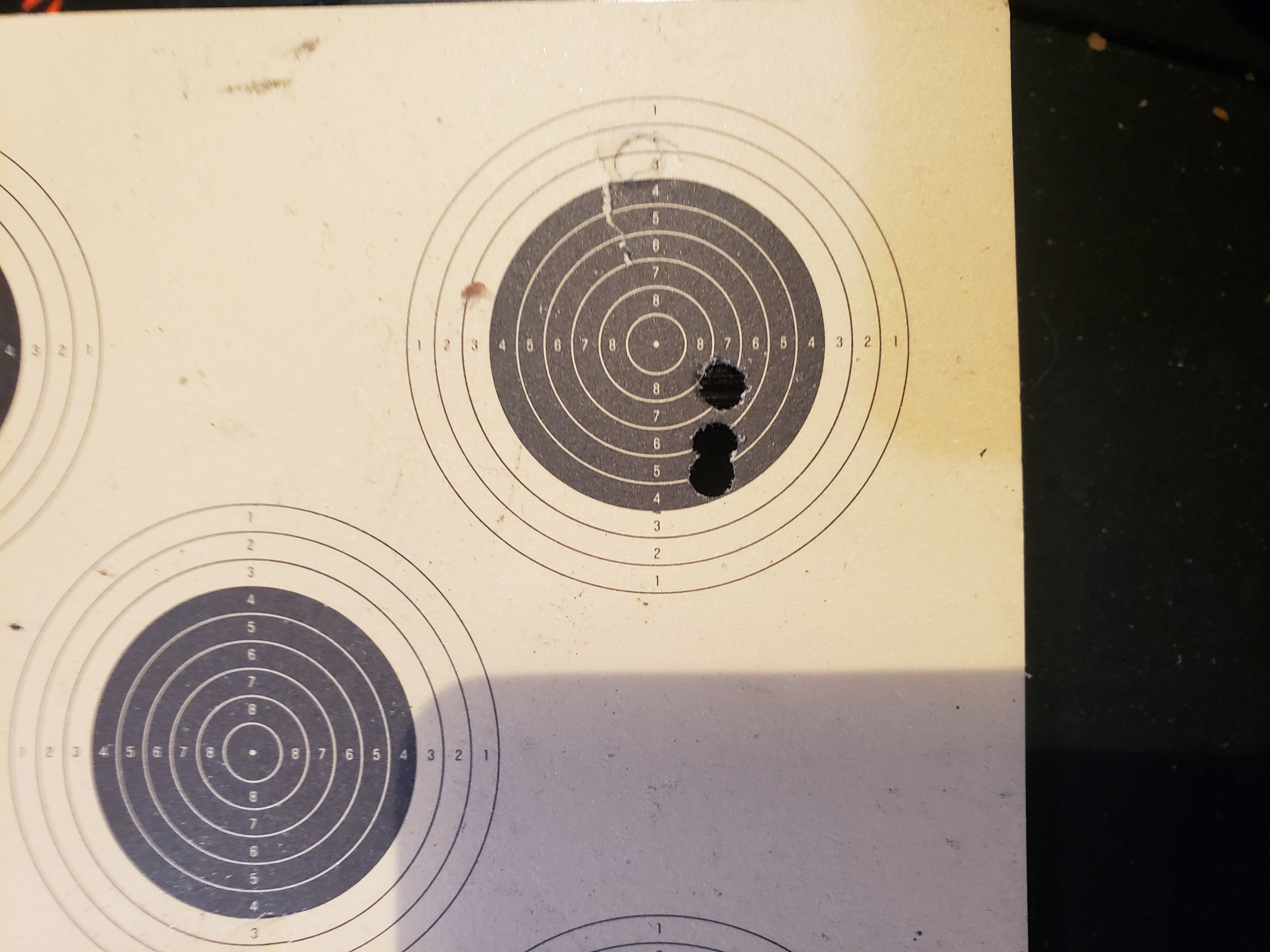

My air rifle is fine as far as elevation is concerned. But when it comes to windage, it runs out of clicks, for the let side. That means I cannot bring the windage from Left to Center (Bullseye). Any tips?

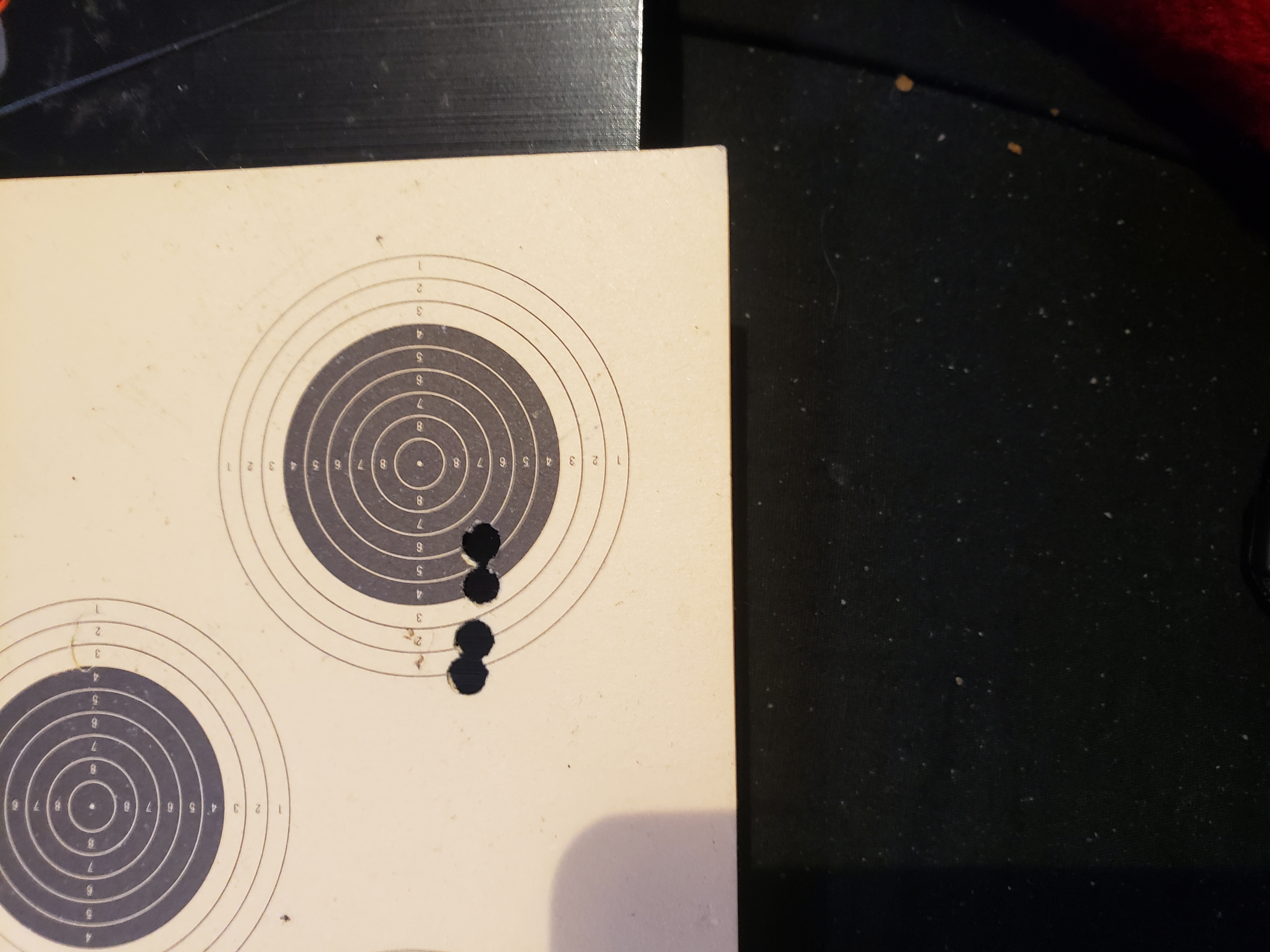

This concerns my Steyr LGB-1. Notice that the elevation was not a problem, as shown on the two photos. As long as they land somewhere close to the bullseye (10) it was fine. Plenty of elevation clicks remaining, so no problems. The real problem was about wind-age. The pellets would land running out of (Left) Clicks, that was, could not go further right to nail the bullseye (9 or 10). One of the targets I did manage (or rather the bench make it happened) I did not know that the pellets ended up as a shot on top of another. That were all 5 pellets went through the same hole. I actually thought something was wrong with the rifle because there was only one hole on the target paper. However upon closer examinations it turned out that all 5 shots were on top of each other. After all, the hole was not perfectly round. Unfortunately they were just touching the 8 ring. The click problem prevented the pellets to be closer to 10, ie went further to the right. 8 and 6 were simply unacceptable, because I have a test bench (Tec-Hro), so there was little to no movement at all. Once I took my first aim, I basically just keep pulling the trigger until the pellets were all gone, and was ready for another test batch.
I *do* worry that there maybe something is wrong with the barrel such as bending very very slightly, but of course, very very slightly was not acceptable.
If there are no more suggestions for this post, I guess I will have to talk to Buck and ship the rifle back. It has been twice that we had to ship it back and forth, to the point that we kept using the same cardboard box. Mostly my fault though. This rifle made me appreciate long arms again. I thought my Parkinsonism essentially ended my ability to do target shooting.
